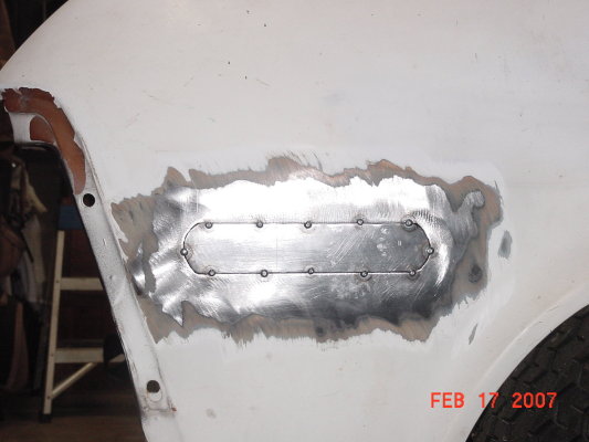

      to fix the hole......should i cut it and tack a small flush patch then just fill it in? similar to the attached pic but much smaller patch. I understand that the area is somewhat structural but affected part is pretty small. Or should I clean it up and weld the patch over the hole from underneath the the wheel well? Above pic looks worse that it actually is. The rust in the seam is just a surface rust with the exception the hole area.
      • ETurdy
        • Oct 2017
        • 11
        Maybe you're already aware of this, but the first step prior to actually fixing the hole should be to determine the full extent of the rust. You will want to get down to clean metal all around the hole so you can identify any areas that may be thin, even if they aren't rusted through. Thin spots from surface rust can make it difficult to weld in the new piece since it will be very easy to burn through these areas. I've found a wire wheel on an angle grinder to be a good way to quickly remove rust down to bare metal without too much risk of removing good material (like can happen with a flap wheel). What you find at this stage will inform the way you go about fixing it.
        Once you've done that, I would recommend cutting out the thin areas surrounding the hole with a cutoff wheel on an angle grinder. Try to make a rectangular hole so that the patch is easy to fabricate. Since the geometry in this area is pretty simple, I think a flush patch would be a good solution. Make sure to avoid large gaps since these will be annoying to fill without burning through repeatedly. If you're worried about this, an overlapping patch can be used. You may want to weld from both sides to make sure you don't leave any opening for water to get trapped in.
        Once the patch is in, the rest of your plan seems good. Rust converter, seam sealer, paint, etc. Make sure all bare metal is treated, and make sure water can't get trapped anywhere.
        One final word of caution - rust rarely looks worse than it is. Typically, the wire wheel will expose much more thin material than expected. But hopefully, that will not be the case this time!
        Best of luck to you. Let us know how it turns out!

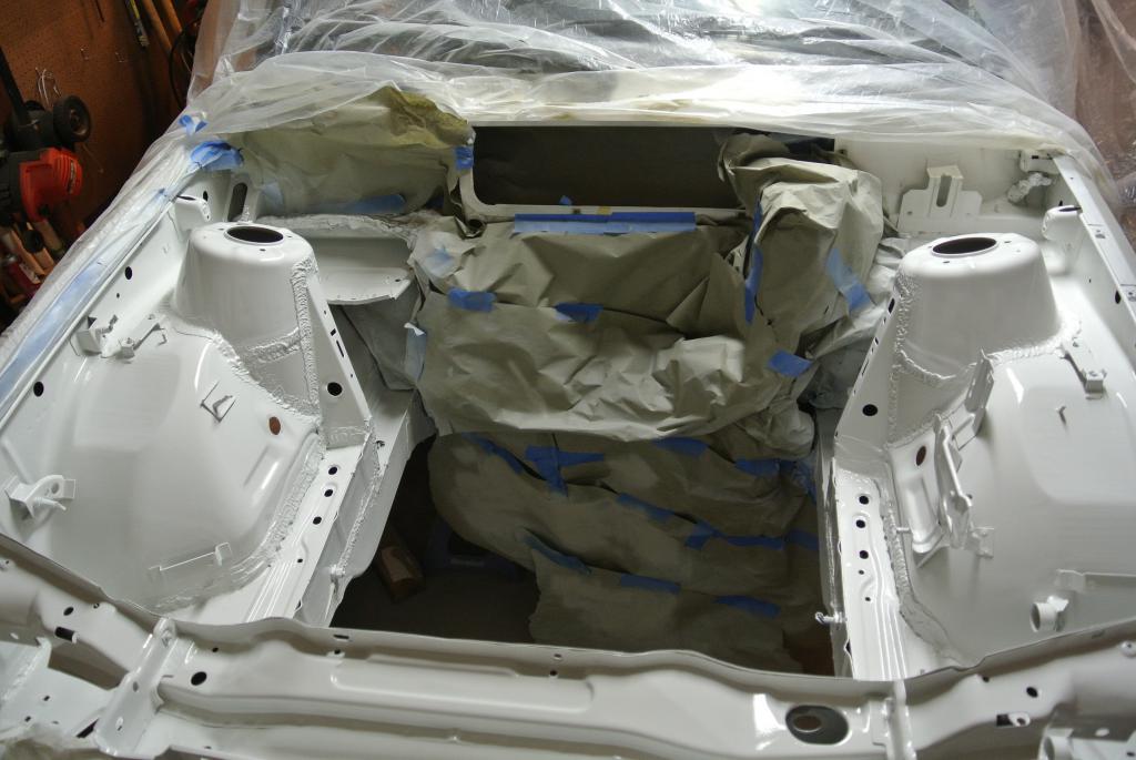

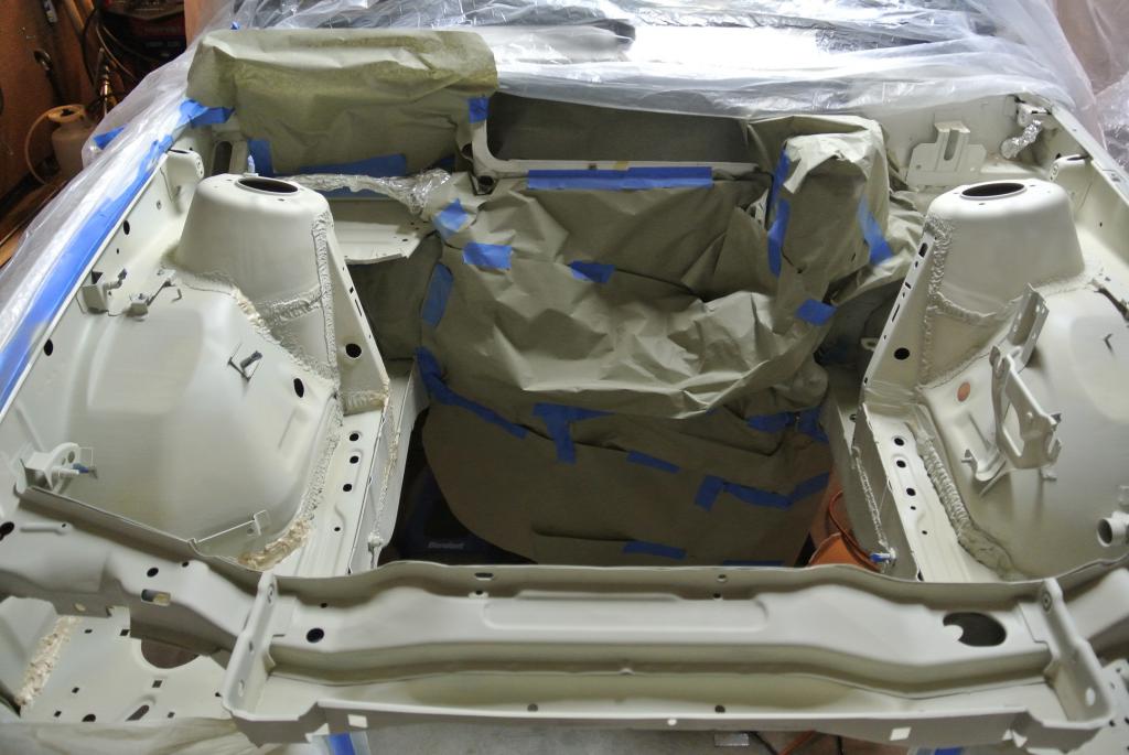

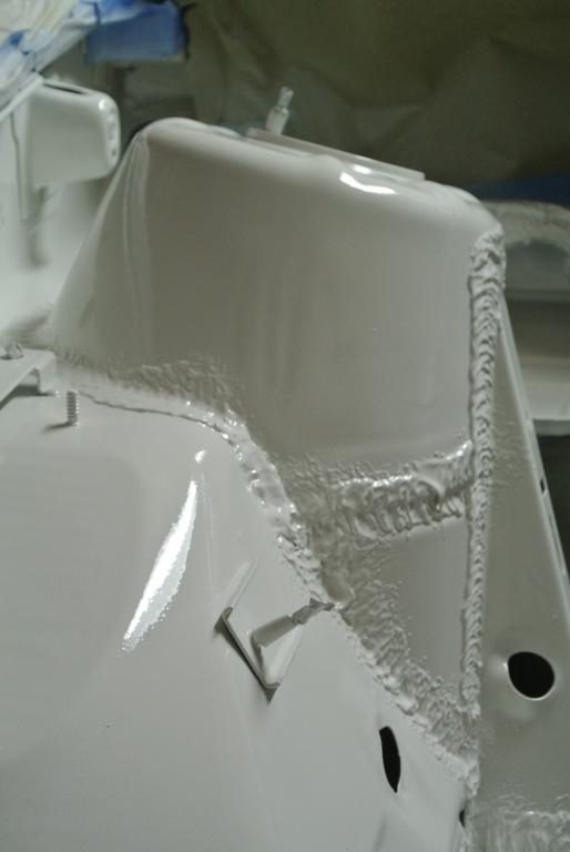

                            long overdue update. Self etch test strip hold up to seating in the snow and salt for a month so I decided to leave the patch. I did end up scraping all self etch from the surface where seam sealer contacts. I used 2K epoxy primer on bare metal, 3M Ultrapro seam sealer and painted the engine bay with 2K single stage Alpine White 2 code 218.
                            It was a pain to match factory messy seam sealer...I tried.
                            Happy how it tuned out so far. Can't wait to drop freshly assembled 2.9L stroker in there. That engine was sitting for way too long now
