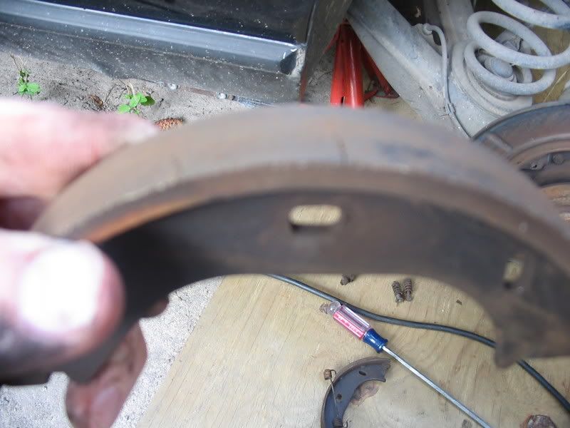

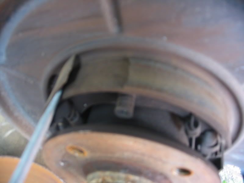

                        The shoes on the E-brake will crack and fall apart, Making the handle go way up. Ive replaced the shoes on all 4 of my E30s. It is a super PITA
                        Adjusting it SOMETIMES Causes the metal part of the shoe to dig into the drum
                        • delatlanta1281
                          Dart Master
                          • Mar 2006

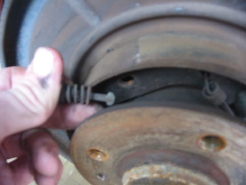

                          • 10317
                          The change isn't super hard as far as the shoes go, just frustrating. That lille clip is the pita. Be patient.
