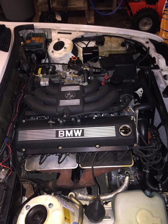

          I just took mine off to do new coolant lines but I also cleaned up the crab with carb cleaner and a brass detail brush. The detail brush made quick work of the general yellowed cosmoline and also I cleaned up the injectors, injector mounts, and restored the true shape of the injector dome.
