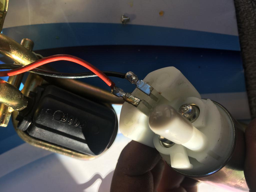

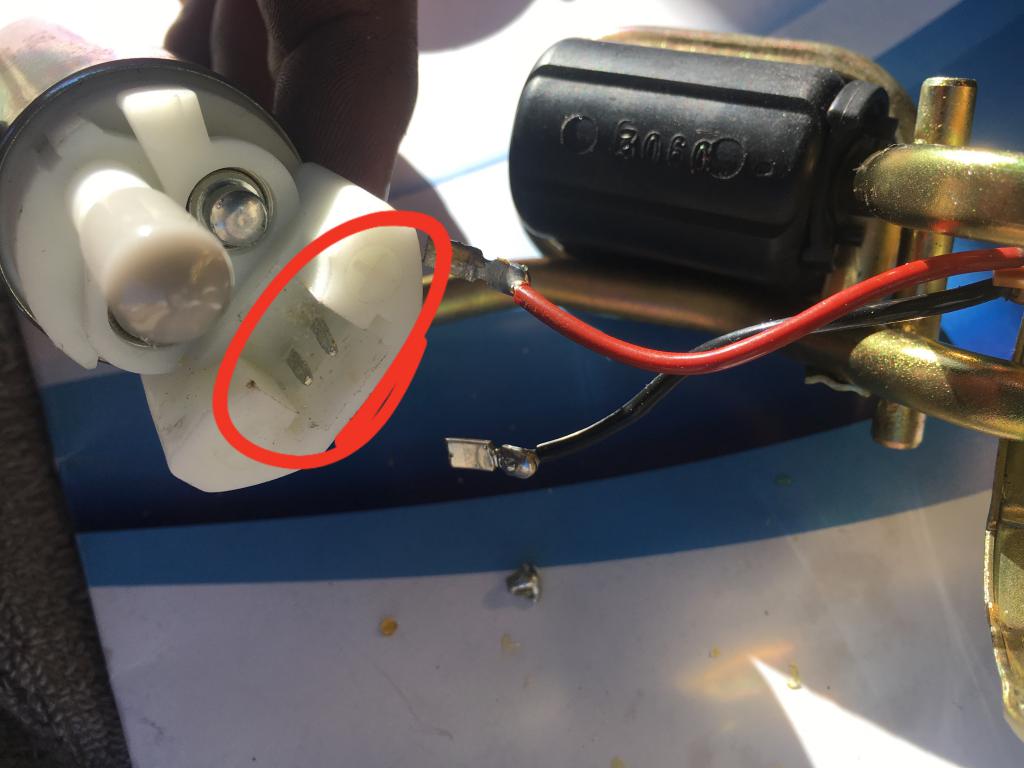

ID:	7198514I’m replacing fuel pump motor. Is there a special connector i need to use for new pump? I tried soldering but its not going so well. It’s probably a bad idea too.
                        Any help would be appreciated.
