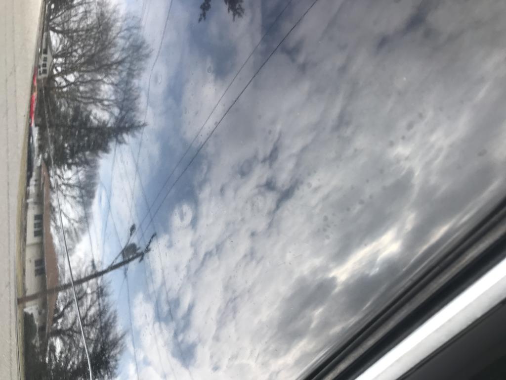

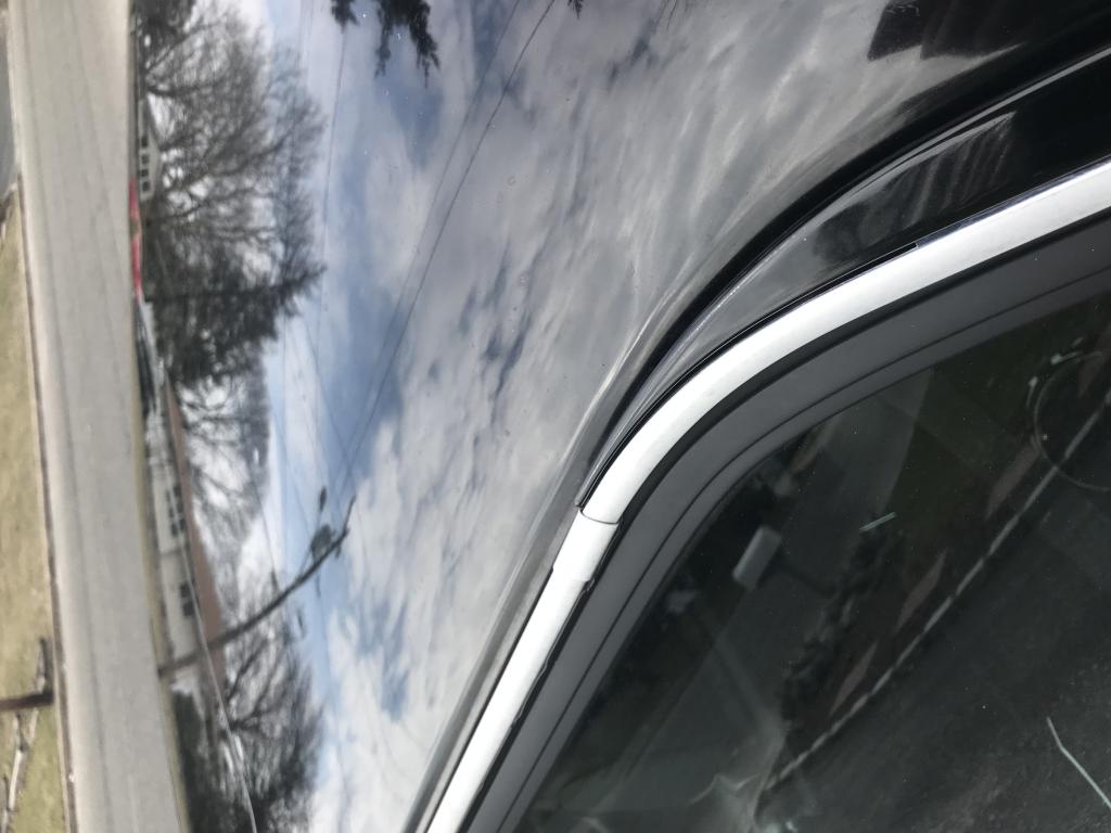

            Tried to get a couple pictures but it was hard to get the right angle to capture them.

              you guys get small hail? its the dark little cloudy spots, right? it is hard to tell in the pics, you are right

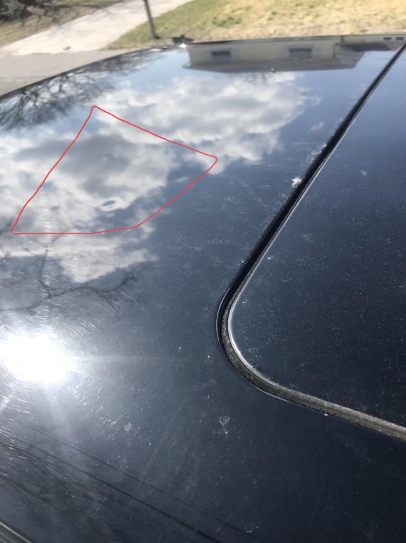

                I purchased the car like that. It is from Georgia so I’m assuming it happened there. I took another picture and circled where you can see some. They are all over the roof though not just in that one spot
