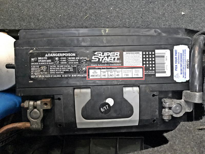

                        E30 battery tray can hold both groups and they have the recommended CCA thats why.
                        As Barry said Group 48/H6 and 94/H8 meet the requirements.
                        Pic of my battery below (scored at PYP for $26).
