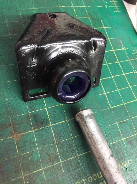

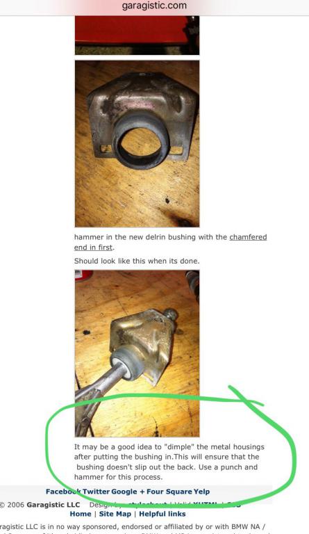

    Garagistic rear poly shift bush loose in carrier
    Per mfgr I burned out stock rubber, pushed in Garagistic poly, dimpled the carrier with a center punch and still find the bush loose. I can push it out with modest finger pressure, which makes sense as that is how I installed it. I have replaced a good many dozen bushings and unless they are mechanically restrained they almost almost go in with a vise or hydraulic press.
    I can dimple the housing more aggressively but want to ask the forums experience with same.

    Hello! Give us a call or email and we will walk you through securing the bushing. Thanks!

        If the little dot on the top in your first picture is your dimple, that is no where near enough. It needs to be big enough to dent in the ID of the housing or else it won't do anything.

              Solved by both filing knob at rear of alum carrier all the way off and a ring of jb weld around the rear perim of the poly insert. Later was mfgrs suggestion.
