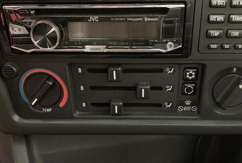

        For what it is worth, some E30s are picky about vent configuration. Try configuring your vents roughly as shown below.

          Interesting. Any idea why the vent position matters?
          • nrubenstein
            • 3148
            IIRC, it was to prevent freezing the evap in earlier models. Our '88 does it. The '89s and '90 don't.
