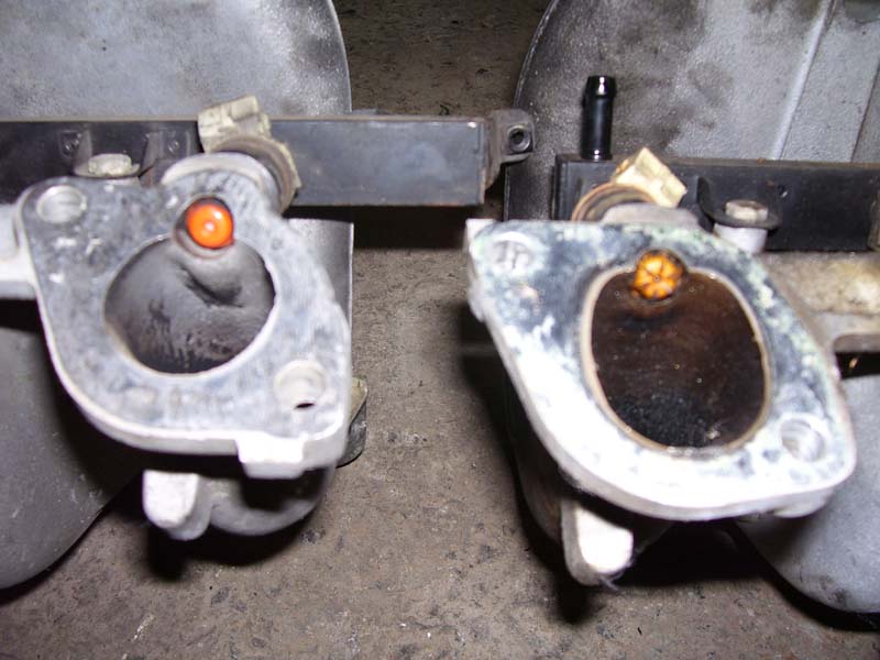

            How do you plan on working an ETA head to be better then a 325i head? Have you ever looked at the ports? Here's a shot of the shape of the ports (obviously not the head, but the shape is the same).
            I'm not sure you'll get any more torque out of an ETA. Just add a chip and call it a day, you'll only be marginally slower then a 325i if you put a 3.25LSD in.
              Even though that's quite a bit of meat to be removed, i'm sure it's not impossible to port a 325e head out to similar specs as a 325i.
