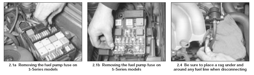

        which fuses should i check? there are 30 of them and i changed most of them recently... and which one is main relay? one of those 6??? or the longer one?
          PLEASE HELP i cant start my car... :(

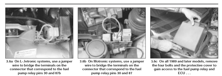

            Hi, well try what is shown in the images attached, if not, visit this link, and you can download all the needed info in pdf.
            Download nubers 4 and five, they have all the info you need, unfortunately i have an M10 engine, but not fuel injected, mine is carburated. Si i don't know much about yours.

                    There should be a way to hotwire your fuel system just at they hotwire some things in that engine.
