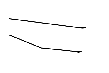

    you have to bend them downwards a little bit.

          Originally posted by 87-325ic
          how so?
          like put a little crease on them...?
          what did you use to do this?
          I haven't done it, but I read the article on a porsche website a while back. visually, it looks like the attatched picture. by bending it somewhere in the middle, it will sweep a lower part of the track.

                  This might be a little help:
                  There is a picture of the contacts at post #71. Basically just bend them little so they touch a different portion.
