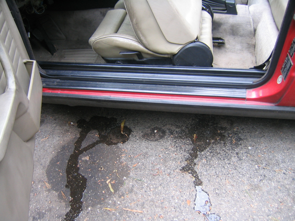

                here's my Zinnno ic taking a peeh :)

                  Originally posted by fporro View Post
                  issue was the exit ports (2 per side) on Rocker Panels were clogged up.so inserted a wire hanger from underneath car at front and rear spots,now water channels out as it should.
                  there's also small tabs on the floor that you can undo so area can drain out/ventilate it self...
