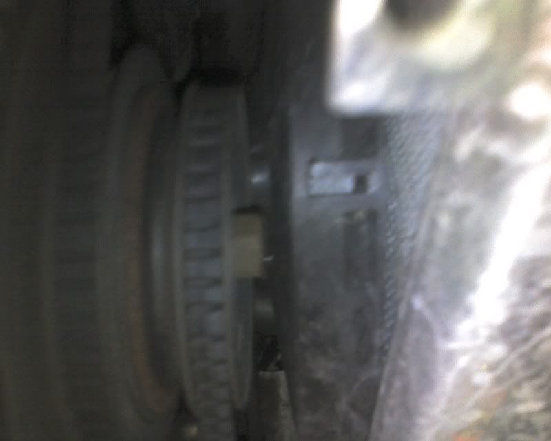

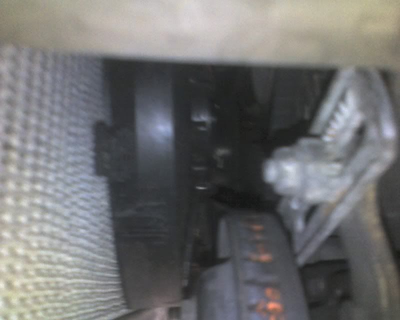

                                So yeah.... I took some cell phone pics of the before and after for you guys:
                                After:
                                The pusher fits ridiculously flush in between the intercooler and radiator, but it works. It idled for half hour with no sign of overheating. I took it out for a spin and it maintained its temperature then as well.... but this was at night (mid-80s temp)
                                We'll see how it holds up to a drift event tomorrow in the eye-gouging sun.
