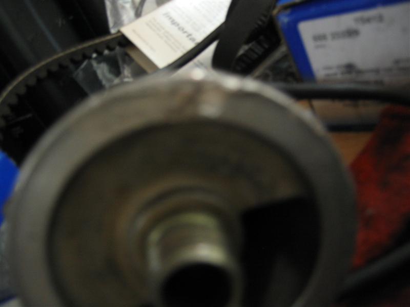

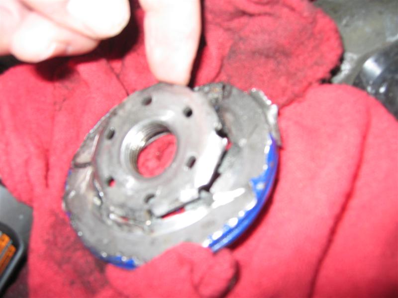

            did almost exactly that yesterday, sorry I didnt get the update. IT'S OFF! Two cutting discs later this is what the top of the filter looked like (i cut from hole to hole and the center part came out and threaded off, then the rubber seal and gasket sealer goo pried right off:
Name:	oil filter2 001 (Medium).jpg
            Downside is the million things I did to it, I put some gouges in the metal. Sorry for the crappy picture, I was on my way to a new years party when I took it and was trying to rush.
Name:	oil filter2 003 (Medium).jpg
            Doesn't look to bad, but hopefully I can have that surface machined flat to make me feel better. Luke gave me a spare with all the seals rebuilt so in the interest of moving the car out of the driveway, I'm going to put his in the car, have mine machined and rebuild it with all the gaskets before giving mine to Luke.

                  I saw that when I bought the car, but no leaks, and I'm not planning on keeping this engine / tranny long term anyways. I thought it was real welding and someone built up the metal. Dunno how to test that, but you may be right, might just be a handful of jb weld.

                    You want to have your damaged oil filer/cooling housing machined to repair the gouge you put in it with the cutting disks? For a $35 used part....
                    Below the radar...
                    • browntown
                      • Jun 2004
                      • 3524
                      I owe luke a filter housing, and I'm going to give him one in as nice of shape as he gave me. Machine shop will have it done for $25, picking up on Friday. So yes, it's a small price to pay to take care of someone who helped me in a pinch.
