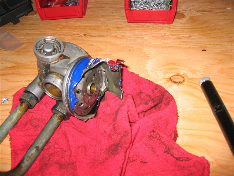

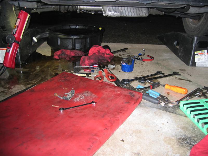

    I'm at a loss of words, I've been on my back for four hours f*cking with the oil filter. I hate the first oil change with a new car, P.O.'s always over tighten oil filters.
    It gets worse. I tried all different types, strap type wrench, thing that goes on ratchet, even some pos claw thing I found at walmart at 9pm. Nothing budged. Before some genius asks (lefty loosy?), yes I was trying to spin in the correct direction.
    So it occurs to me that my father once told me you can stab a filter with a screwdriver and twist. I try it, and oil in my hair, all over the garage floor, and a severely mangled filter. At that point the best idea I could come up with was to remove the entire housing. Futzed with it like that for an hour, and finally I just took the whole oil cooler and lines out.
    Here's some pictures so you can laugh at my misfortune. The bugger is still on there and I tried to cold chisel the mating surface and found what appears to be GASKET SEALANT!!!! I'm going to shoot the man who did that.
    So I'm screwed, I don't know how to get the stub off the housing. I've tried drifting the holes in the base of the filter body to no avail. I got a car with a big hole in the side of the engine and no oil. Just on the floor.
    I hope tomorrow to get creative and separate the two, get to the dealership for some gaskets, and put everything back together again.
    I don't suppose there is an oil cooler delete kit that would allow me to spin the filter directly on to the block is there??

        OMG! lol... maybe you can dremmel one corner of the oil filter housing and then split it open ?

              Bummer you had to do all that... Dremel that bitch out tho. Either someone put it on way too tight or never did an oil change.

                  put it in a vice, and tighten around the crown of the filter, it will probable fold, but once you get it tight. just turn, maybe spray some pb-blaster on the threads..buut jesus christ, i thought i fucked up once when i had to use a screwdriver..
