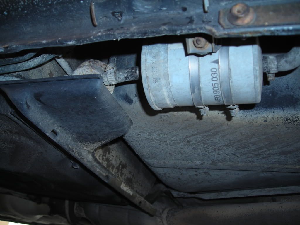

                              What is that silver canister thing under the car? This is on the drivers side in front of the rear wheel. It was making a humming noise.
