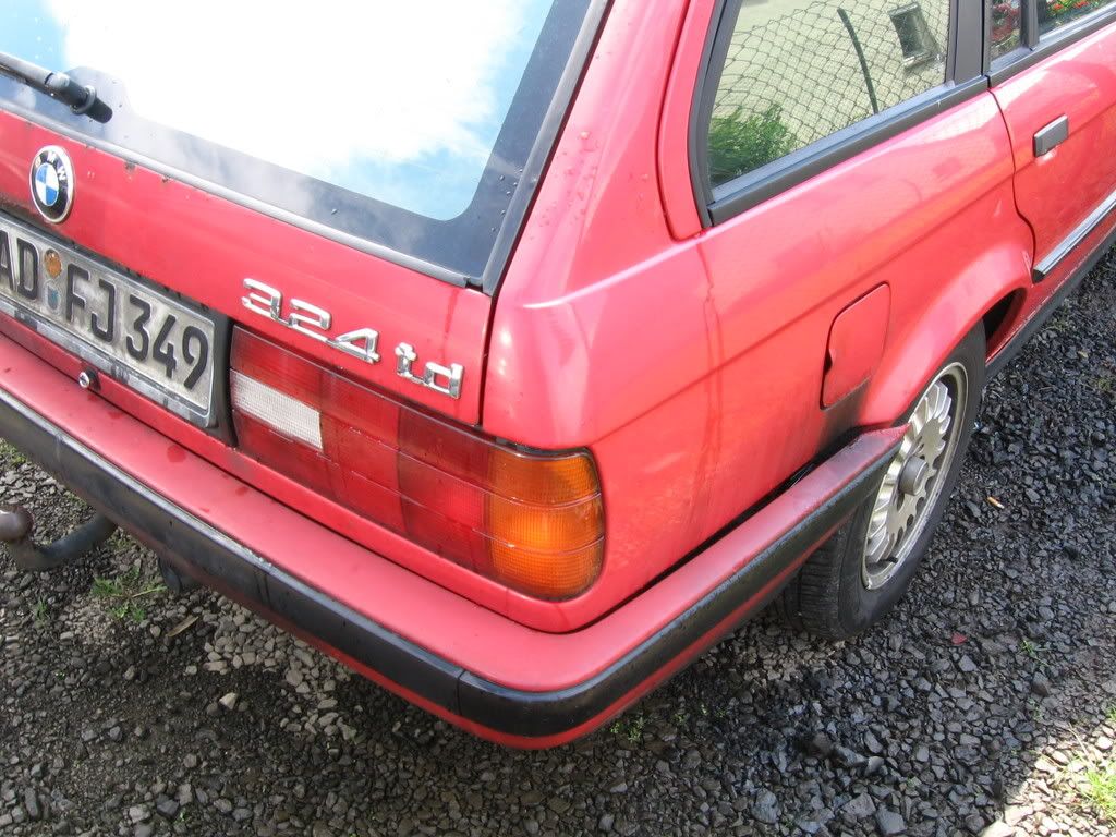

                      here is a car in my yard that used to run on Burger King french fry oil, and a few times on Thanksgiving fried turkey oil. the biggest problem was the filtering process. the injector pump was ruined from pieces of turkey once, and the complete fuel lines and filter were plugged with hardened BK grease a few times.
                      The last kick for the car was the propane injection with 50/50 diesel/ BK oil. the injector was drilled out to be as big as possible. ran great, but the belt came off the gen, owner didnt realize it, and drove it itll it overheated and quit!.
                      not my car, but my buddies beater.
                      notice the hole in the intake boot after the turbo, thats where the injector for the propane was.
                      notice the grease stains on the side of the car. oh, and stock I thought the car felt faster than a euro 320i- but that still isnt that fast- but faster than an ETA!
