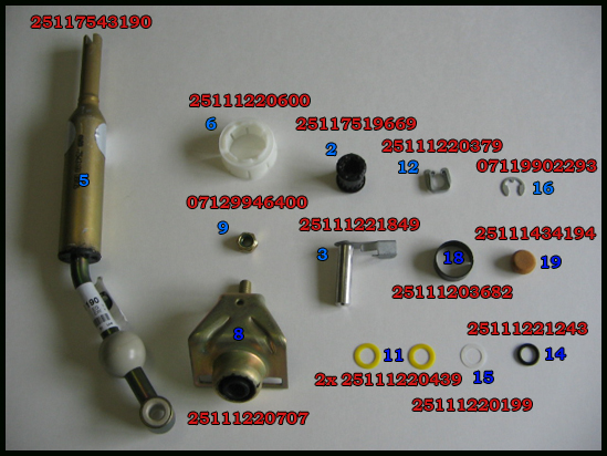

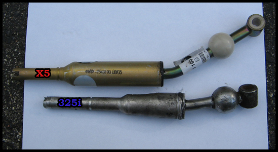

          I installed an E53 X5 shift lever because, to me, the term "short shifter" means short throw shifter. As you can see in the picture below, the lever arm below the pivot point is longer than on the stock lever which means the throw is shorter. The throw is less than stock, but I've gained a couple inches of height on the lever.
          On another note, I replaced all the bushings in the shifter linkage with stock rubber and I still have some slop. I don't think this is related to the longer shift lever, but I have not looked into it yet.

            Holy smokes that shifter is loooong!
            You're definitely right, the throw won't be long at all because of the elongated section beneath the pivot ball.

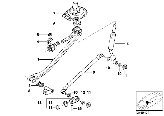

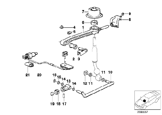

              That's the X5 shifter and all the parts for a linkage rebuild. The blue numbers correspond to the realoem.com diagram.
              Edit: ^ E30 linkage.

                  Just so there's no confusion, the above linkage image is for the E30. The following image is the E53 linkage:
                  ...but yes, the E53 X5 does appear to have a bitch clip.

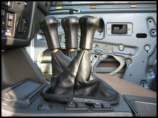

                        I have this, I can touch the steering wheel while in reverse.
                        z3 something that has the longest bottom portion.

                          well, i was using the term "short shifter" to describe a shifter that is short in length, not a short throw shifter.
