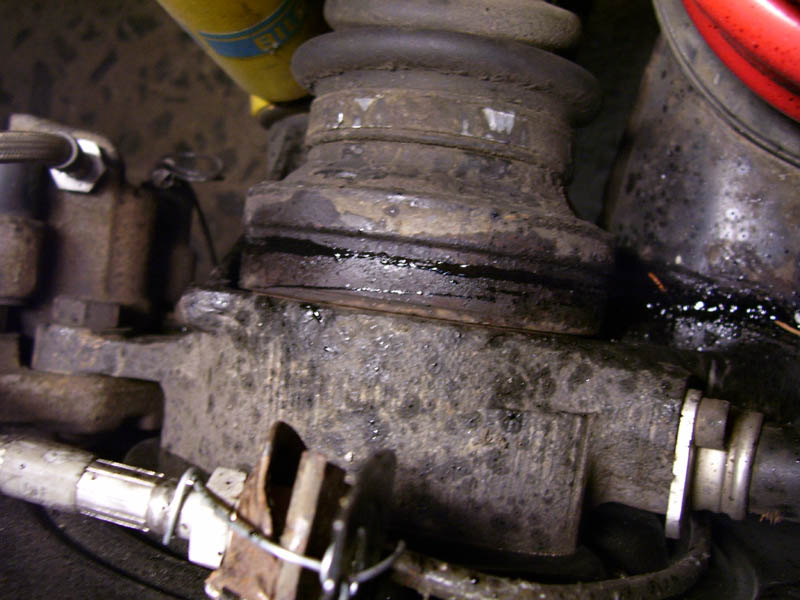

I did my rear wheel bearings last week, and had a lot of trouble with the passenger side. The puller ended up cutting into the teeth on the hub a bit. This made pushing the axle through rather difficult. I ended up having to tap on the backside with a hammer to get it in far enough to thread the nut. After that, the nut pulled it the rest of the way, although somewhat hard.
Anyway, I put maybe 100 miles on it and jacked it up to double check my work. This is what I found:
So how is it coming out from in between those metal plates, and what do I do? A decent amount came out, it was splattered on my wheel and trailing arm. I cleaned it all of and put another 20 miles on tonight, I will take a look tomorrow to see if anymore leaked out.
