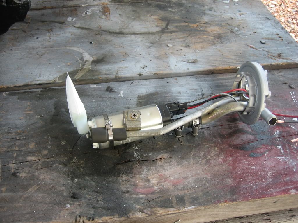

    I did a warbro hp 255lph, a bit noisy but has worked well. I got rid of the external pump.
    The reason for the rubber part on the bottom of the return tube was to prevent the body of the pump from hitting the return and causing more vibration. Obviously in this pic I had not finished the wiring yet. :)

        How did you get it to not leak where the wires come through? Even if you put the level sensor back in and move the wires elsewhere, it looks hard to get it to not leak.
                The wires do not exit where they are in the picture. The red wire goes to where the stock power wire enters (you need to de solder the sock wire and solder the red wire to this location. The black wire I soldered on a crimped on ring and connected it to the screw you see in the pic, that is where the sock pump is grounded. Basically it hooks up to where the sock pump hooked up. Just remember if you eliminate the external pump you need to re route those wires to the internal pump location, the ones at the stock internal location are not thick enough to run the new pump.
                The reason I went with the walbro hp255lph pump is that I could live with a little whine I do not want to starve my turbo at high boost when I install it. I have heard some have had problems with the TRE's failing on them that is why I did not go that route, also I have been running the the same warbro type pump in my firebird for years and never had a problem.
                I got mine from www.fiveomotorsports.com I used the GSS341
