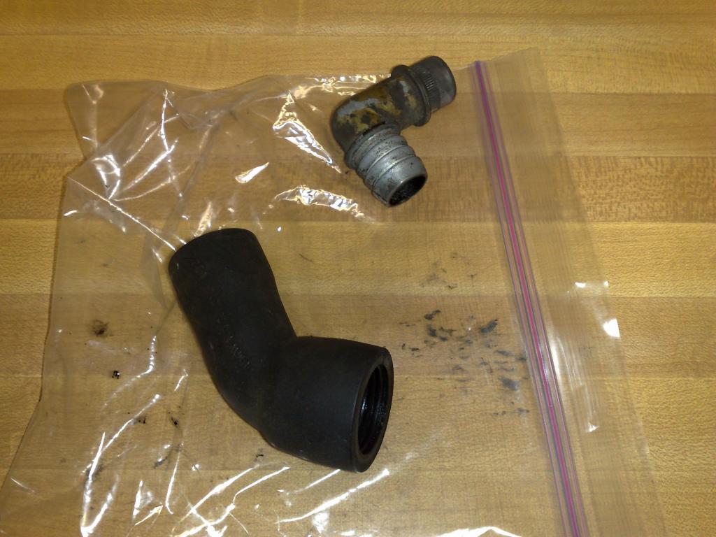

                    Ok...now when I removed the hose to be replaced (lower part of picture) I also noticed this aluminum 90 degree elbow that looks like it is press-fitted into the intank manifoldin line with the hose I am replacing. THis thing is supposed to he a sealed fit, but when I put it in place you can kind of rotate it around...any suggestions? its on the top of the picture. how do I intstall that thing and have a seal so I don't have vaccuum loss??

                      The rotation is ok. The tapering on the idle control valve creates enough seal for that particular vacuum line. There isn't enough pressure in the vacuum system to create a leak there.
                      To further reassure you, mine does the same thing and I have no idling problems.
                      Just press the ICV into that aluminum elbow and the other end of the ICV into the intake boot.
                        if you want a tighter fit there you could always wrap it in thread tape or something then install it.

                          thats good news...i figured if it rotates its not air tight and may contribute to ill-tempered iddling. i should have the hose in soon...its a waiting game now.
