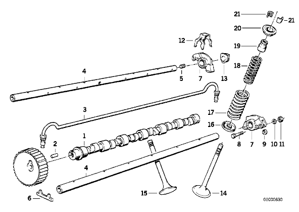

              what parts constitute the valve eccentrics?
              thanks
              • TwoJ's
                • Oct 2005
                • 4908
                thanks
                the little round pieces of metal that are held by a nut on the tip of the rocker. They are adjusted by loosening the nut and rotating. They are what the top of the valve stem contacts.

                  okay and should i be ordering new ones?
                  any one have a part#?

                    • akorcovelos
                      • Dec 2006
                      • 1149
                      #9 in the diagram, part # 11331744354
