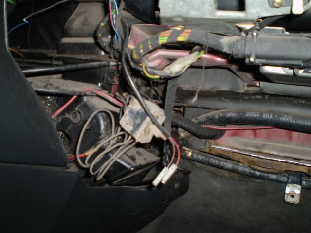

              Here you can see the two actuators on the left and right sides, they are facing each other if you will, the rods go towards the front of the car.
              • chileelky
                • 47
                Jean, :bow::bow::bow::bow:
                there they are - the 2 metal colored round pieces (w/yellow tabs) below the square scoops w/fins???
                My car is 82 323ia, very first bmw, learning die hart way to get another decent rice eater but up to now more used to this other rides
                Thanks for your help
                • Jean
                  • 18228
                  Yep, just below the left/right air vents that feed the air into the dash. The actuators move the rods, and in turn close/open the vents (flaps) on the other side of the box where the blower fan is located.
