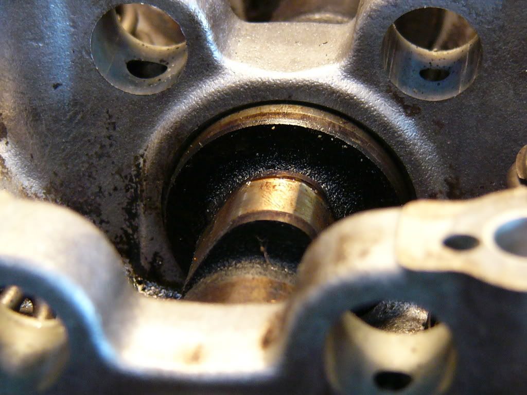

                        Have you ever pulled off the valve cover?
                        Notice that odd looking tube that runs across the top of your motor, over the cam? Notice the several little holes along the bottom. They squirt oil.
                        That lubricates the little shoe that rides the cam...that little show has LOTS of pressure on it.
                        If that tube gets clogged, cam gets no lubrication...causes this horrible cam wear:
                        Moral of the story is do something about that spray bar. Clean that bitch a couple of times after you do ATF or Lubro-Moly or (my choice) Marvel Mystery Oil.
                        Then after you can keep the oil clean for 800 miles or so, replace it.
