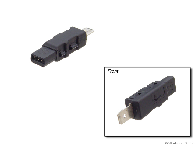

                              Ok, I've been staring at the diagram for a couple hours now, going through the circuits trying to figure things out. Thanks xLibelle for posting this.
                              Question: I noticed a "diode" in the diagram. I also noticed that it appears to be a common replaceable part from vendors. Not sure I've ever seen it in the fuse box.
