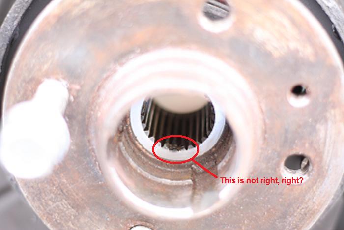

          possibly, but after thinking about it for 2 seconds, It might not be the bearing but I think I might change it anyway. But here is what I found when I pulled the axle and my new question is what part is this so I can get a new one. thanks again!;)
          Edit: excuse my stupidity, but is it all just part of the hub?

            The hub and bearing are separate entities on the rear. I'm not sure what I should be looking at here though.

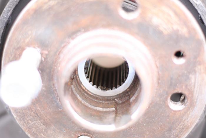

              is this better? :)

                Ahhhh. Broken splines. Probably a good idea to replace it. Looked like crud on there before.
