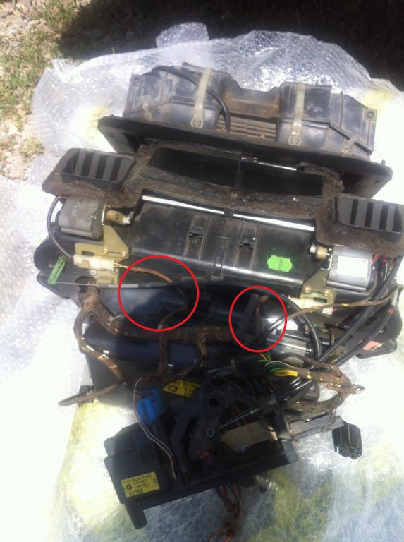

              Well i found the problem, it was down to my fault as well as the system.
              Basically my E30 is equipped with an automatic heater AND climate control regulator. In essence, the temperature knob is a small ECU, which uses temperature sensors from the blower housing (external temp), driver's side footwell (interior temp) as well as directly on the regulator itself (cabin temp).
              This system does not have the typical relais found on NA E30 equipped with air conditioning from the factory (those silver relais found behind the entire front bezel). Instead, that ECU has a built in printrelay soldered onto the circuit board, pretty much like the SI batteries.
              Thing is, there is constant power (always hot) running through that printrelay, as long as the ignition is on/engine is running. The only difference is when the recirculation button is depressed or not, that relay switches polarity to the flap motors (to open and to close).
              I never knew this, and always assumed someone gutted the harness in my E30 and got rid of the relais (for some reason) and i started to fiddle with the system, when in reality it was indeed fine. That small ECU controls everything, from the heater valve (on or off) to the flap inside the HVAC box (to direct the blower air flow between the heater core or the evaporator electronically) to the compressor switch (on or off), evaporator temperature sensor to the main DME (to increase/decrease idle). The aux fan is bypassed completely, and the snowflake button sends a signal to the fan to kick in at speed 1.
              This setup/option was never available (from factory) for North American models, however i shall post this incase someone has such a setup and requires help . Note, there was an option for automatic heater control and NO air conditioning as well, the small ECU did not contain the relays soldered inside, but the "standard" relays one usually finds according to my research.

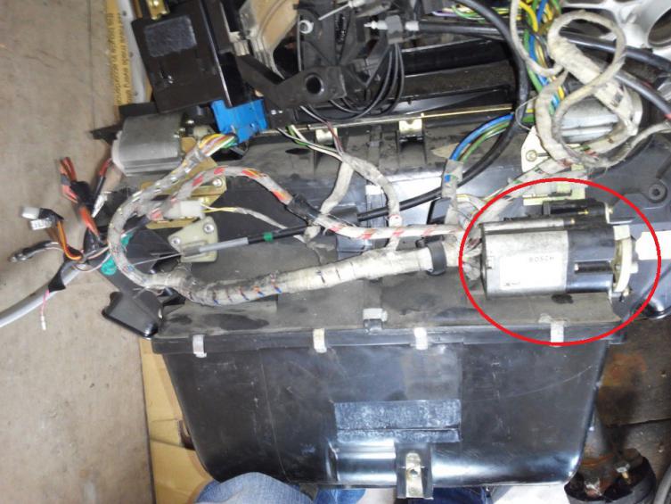

              First picture shows the "actuator" for the ECU how it controls the internal large flap to direct air flow between the heater core and/or the evaporator (cool/warm air or a mix of both depending on temperature setting).
              Second picture shows how the flap motors are directly connected into the HVAC harness without exposed relais, if you look closely, the passenger side motor is double wired/bridged to the driver's side motor.

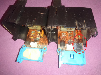

              Here is the difference, the one on the left does not have the relais mounted, which use external relais, the one on the right shows the printrelais mounted.
Name:	Automatic Temperature Control.png

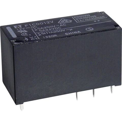

              Like the SI board batteries, one can replace those print relais with a new one.
              This is an 8 pin F1C0012v relay from Takamiswa. One can find them from Radio Shack, or any electronics store.

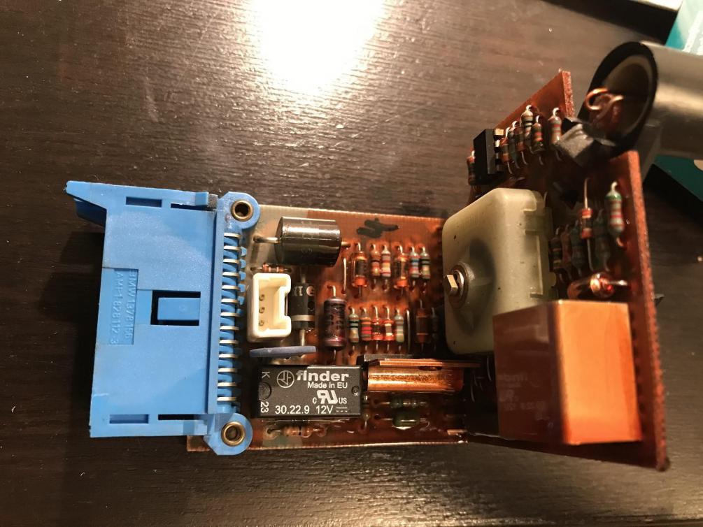

                This shows a new print relai soldered in.

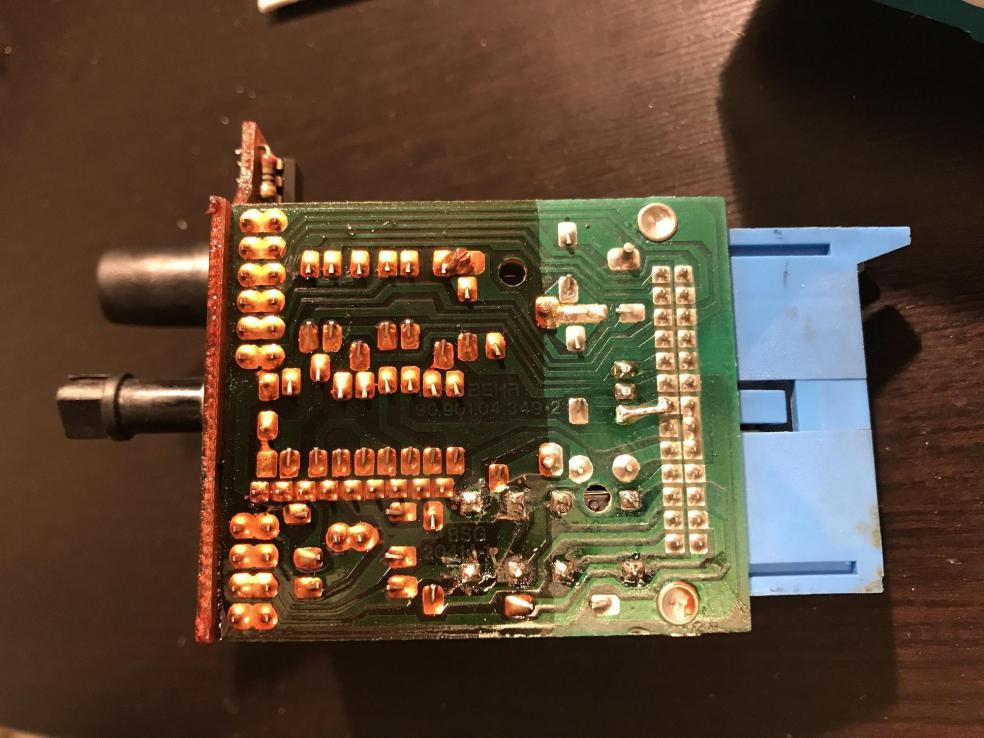

                From the back:
                Apparently this is another very common issue with this system, relais fail. Best method to test, is to apply 12v directly to the flap motors, if nothing happens switch the polarity around. If the motors respond and either open or close and you have this system installed in your E30, 99% it is due to burned out relais as discussed. Also make sure that the motors are connected to the flaps (check the metal arm) and be sure that there is no blockage or broken flaps (the flap pins break with age).
                I ordered two of those relais, they run €2.22 here to have one as a spare. But this would save you €600+ from the dealership where the cause is a faulty printrelai running less than €3 and a few minutes of work.
                I hope this helps out anyone with this system installed and is looking for a solution instead of a new ECU running €600+ from the dealership.

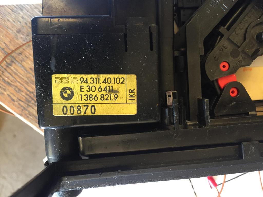

                    Thank you S.J.1981 for another great thread. How did you determine that your car has the auto climate control. I've heard there is a small visual difference on the controls.
                      Cory
                      As you can see from the first picture, there is an electric motor (BMW calls it an actuator) on the right side of the climate control box. In Europe, there are two options, automatic heater and "standard" air-conditioning, then there is automatic heater AND air-conditioning. Basically that motor gets information from the small ECU (it basically receives signals from all three temperature sensors) and automatically adjusts the internal flap to determin how much heat to be allowed inside the cabin (same principal for the cooling). The flow direction (windshield, front vents and foot-well vents) also influence both heat and cooling depending on the sliders position.
                      If you are in NA, then you do not need to worry about this setup, it was fitted to European models only (as far as i can tell). Here in Germany, E30 owners adding climate control to their vehicles actually spending quite some money for this system (everything automatic), i have seen users on German forums spend as much as €1.500 for a while system (compressor, lines, box, harness etc etc).
