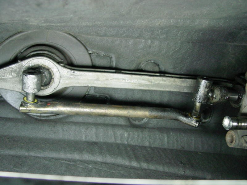

    Picked up a cheap DSSR locally.
    matched up distance on my existing shift rod exact same length.
    bought a newer style shift coupler and the car does not shift into 1 3 5.
    i start googling and find out I should be running 187mm.
    i look at my recently acquired DSSR and it has 189 on it DOH!!!!
    i still can not believe that 2mm makes the difference !!!
    Is thee any way I can use this 189mm dssr without modifying it?

    Can I use an e36 or e46 shifting coupler ?
    • lukeADE335i
      • Apr 2013
      • 1389
      The simplest way to mod it is to put a slight bend in the linkage to adjust it 2mm. The cars with large guibos have a bend in the shifter linkage for clearance anyway (like the e36 linkage below - see the bend at the front of the linkage).
      I did this when doing my swap after being sent a linkage that was too long - I just heated it up a little and bent it to the right length & it has worked fine like that for more than 8 years.
