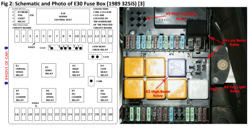

          First off, here is the ETK:
          http://www.wedophones.com/Manuals/BM...g%20Manual.pdf
          Page 6312-0 shows the headlight wiring.
          You must have pulled the wrong relay or there is a short somewhere.It's relay K4, top right in this photo (the one that is pulled out).
Name:	E30 Relays.PNG
          Pull the relay out and if the headlights are still on, check for power at terminal 87 and 87b. These are the two parallel terminals in the middle. If there is power on these terminals, you have a short somewhere feeding the headlights.
