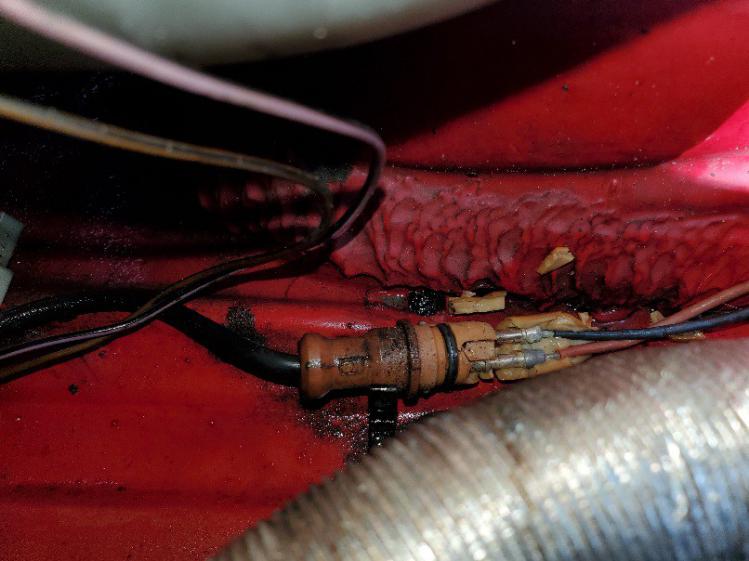

    Plastic connector - ABS?
    These connectors (both sides) are desintegrating. I believe they are the ABS wiring. Is there a replacement available, so that I can remove the pins from them and reinsert into the new ones? What can I do to fix this properly?
  • PieterVN
    • Nov 2020
    • 72
    Check out the following parts number: 61131390540
    This should be the wiring going to the ABS module. To get the other side of this connector you should get a new ABS sensor i think.
    I would try to cut the connector and solder or try some other some sort of more generic connector. Good luck!

      I've been using Delphi Weather Pack connectors when I've needed to replace connectors. I think we can expect a lot of the cable connectors to start falling apart. There are several brands available at your local auto parts store or on-line.
