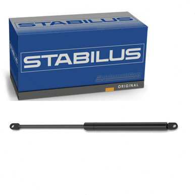

          If you "hit the hood and it sorta fell" you may have bent the bracket that holds it open. Make sure that's not screwed up and you made need to replace the lift support
          This Stabilus 5B-1464BM fits a wide variety of vehicles and includes a 5 Year warranty! $6.99 Shipping on orders $29.00 and over.
