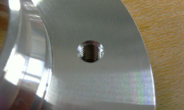

                  I did this this spring to my E30M3. And before all of you ask me to make you a spacer I can say that all on the pictures are sold and that I might make another batch during the winter. Price will be about 1500NOK each set.
                  I use E36M3 calipers, spacers behind the disc (made myself) and Two piece Performance Friction discs. I have had stock E30M3 16" alloy wheels on with them, but I don't thing you can put on 16" split rims since the screws probably would touch the caliper.
                  I run 8.5x18" OZ Racing Mito's with ET21, and with that 12.8mm spacer behind the disc they sits just about perfect.
                  I have used them for about 8000km now and are very happy with it. I have been to the Nürburgring with them and everything is fine. I will fit the E36M3 rear brakes this winter. For that a bracket is needed, and in order to keep the e-brake mechanism I will make a ring that is going to be shrink into the inside of the disc or spot welded.
                  There are made from 6061-T6 alloy.
                  Here are some pictures!

                    ^ any chance you can let me know the actual gap the spacers have to produce between the hub and the rotor. 12-13ish mm?

                      12.8mm, it is mentioned in the text I wrote as well :)
