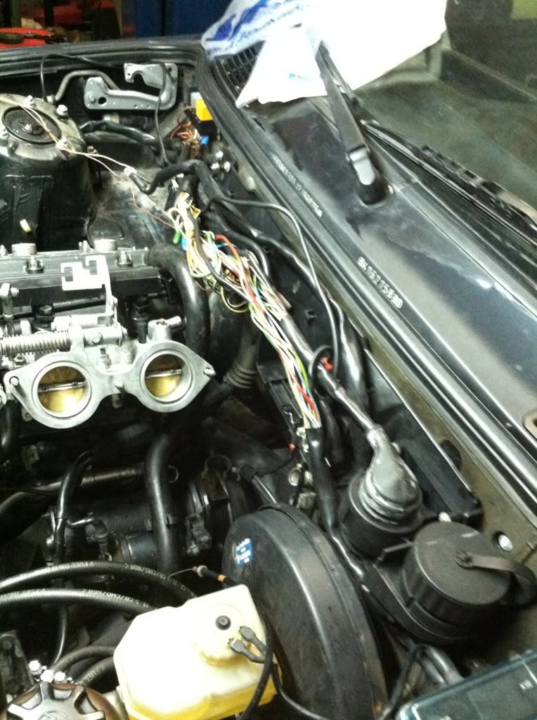

    Hello guys,
    finally got the s14 back into this e30 m3
    hooking up the wiring right now and had this harness out, not sure where it goes. owner of the car bought the car with the engine out already.
    connector
    wire color
    yellow purple/solid brown

    Almost certain it's for the Evaporative Purge Valve.
    If you have the wiring diagrams downloaded it's
    shown on page 1364-6.
      o2? or it may go on top of the coolant res.
        The connector doesn't look familiar, but the wire colors makes me think it may be for the windshield washer fluid level indicator. Your best bet is to look at the wiring diagram on the side of the car where you think it goes and look for those two wire colors.

          O2 sensor is plugged in I have already identified the coolant tank connector. I'll check the purge valve and the windshield washer tank.

            ^^.. is it on the passanger side of the engine,and is it a chassis connection? maybe AC related!

              I received the engine harness in a box and the engine was seperate
              The tape on the wiring loom had been partially removed so it's hard to to say it if went towards the driver side or passenger side.
              Yes It might be ac related
