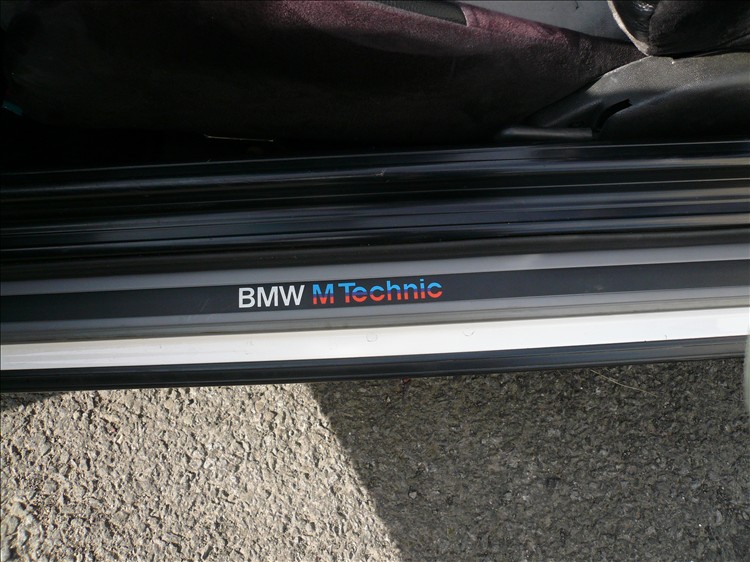

    E30 Convertible M3 Door Sills
    Does anybody know a part number for these? Or know where you can find a pair? My understanding is the Coupe sills will not fit the Convertible.

    I don't see why not.
    88 M3 - LACHSSILBER/SCHWARZE
    • Cabriolet
      • 9620
      51472230605
      verts and coupes can run the same "outer sill plate"
        You are right,, if the car is E30 non M3,, not sure with the M3
        and why ??
        because thie sills is a LOT higher on convertebles vs others,, and thats a reason,, because of the structure of the car ,, no roof that takes the flex-force of the car
            and why ??
            He is talking about the outer sill. the inner sill doesnt not swap between vert and coupe/M3
            however the outer sill, the part with the M on it 100% does swap between the cars. Go to real OEM and you'll see the part #s patch. and i know first hand owning a coupe, convertible and an M3.

              can it be that nr 51472230605 is Evo 2 sills, where ///M3 is white? --> http://www.bmwmregistry.com/faq/E30_M3_sill.jpg
              and ///M3 3-color version are under number 51472230365 which is nla?
              http://www.realoem.com/bmw/showparts...99&hg=51&fg=40
