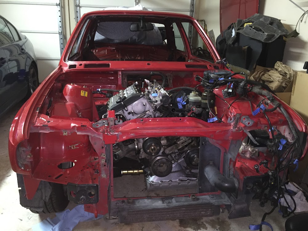

Thanks guys. Part of the thoroughness is because this will be a guide for me when I put this thing back together :D
Now more fun:
