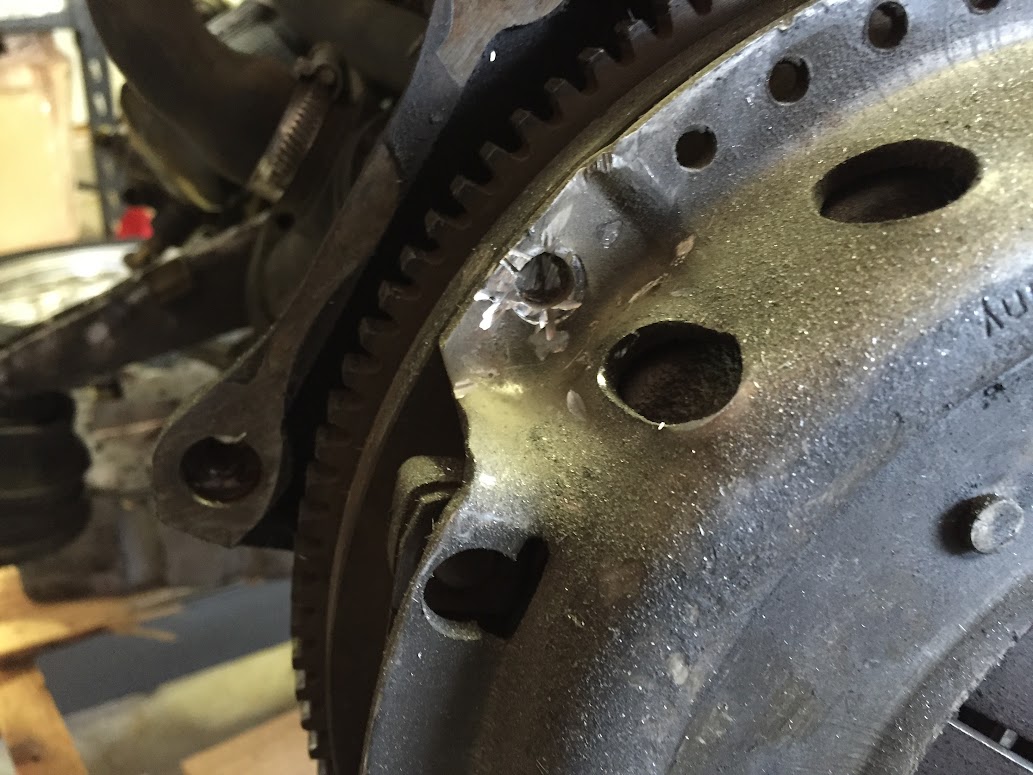

…except one. Dremmel scars from cutting off the bolt that stripped. Going to replace the pressure plate and clutch, so no worries.

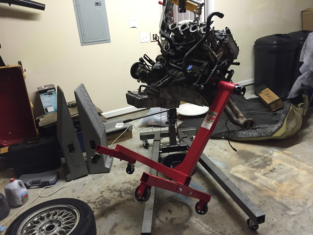

Now for this engine stand. I wanted to mount the engine so that the valve cover was facing straight up to make it easier to work on. The issue is, the engine sits in the car tilted over to the right a bit. I spent an hour or so trying to match the engine to the stand using various positions of the hoist – it was a pain. Things went MUCH smoother when I took the stand apart and assembled it on the engine in the air.
I put down the stand but the engine wouldn’t rotate, took it back off and greased it with some thick all purpose grease.
The first time I put the engine down I matched the insert to the stand. This time I just lifted up the stand and put it on the insert.
It shifted a bit, but was still upright.
WARNING: If you follow this strategy, be VERY Careful when putting the engine down and keep the hoist attached and the chains tight until the stand is on all four wheels. Do not try to lower it too fast. I put mine down carefully and it still tried to fall over to the right. I leveled out the stand with my body weight and it never got away from me, but if someone was hurrying this could go badly. It’s a lot of weight and can be dangerous. So, be careful.
I used hardware from Fastenal to mount the engine. Some guys have used the OEM hardware, but I don’t think the top bolts work. As best I can remember, these are the sizes I used. (got from S14 .net thread here: [IMG]http://s14net.vbulletin.net/forum/s14/general-e30-m3-discussion/46136-putting-an-s14-on-an-engine-stand)
(2) M8x1.25 70mm length
(2) M10x1.5 70mm length
A few pics

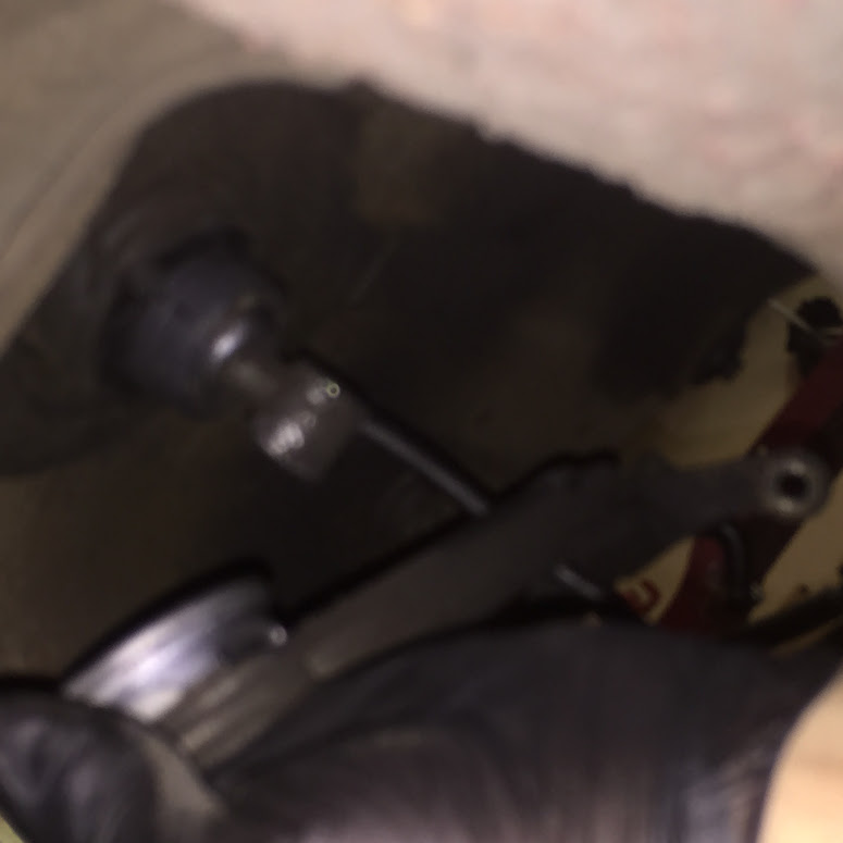

And removing shift linkage. This boy was pretty tired. Explains why the shifter would swing back and forth like an inverted grandfather clock pendulum.
Potato again

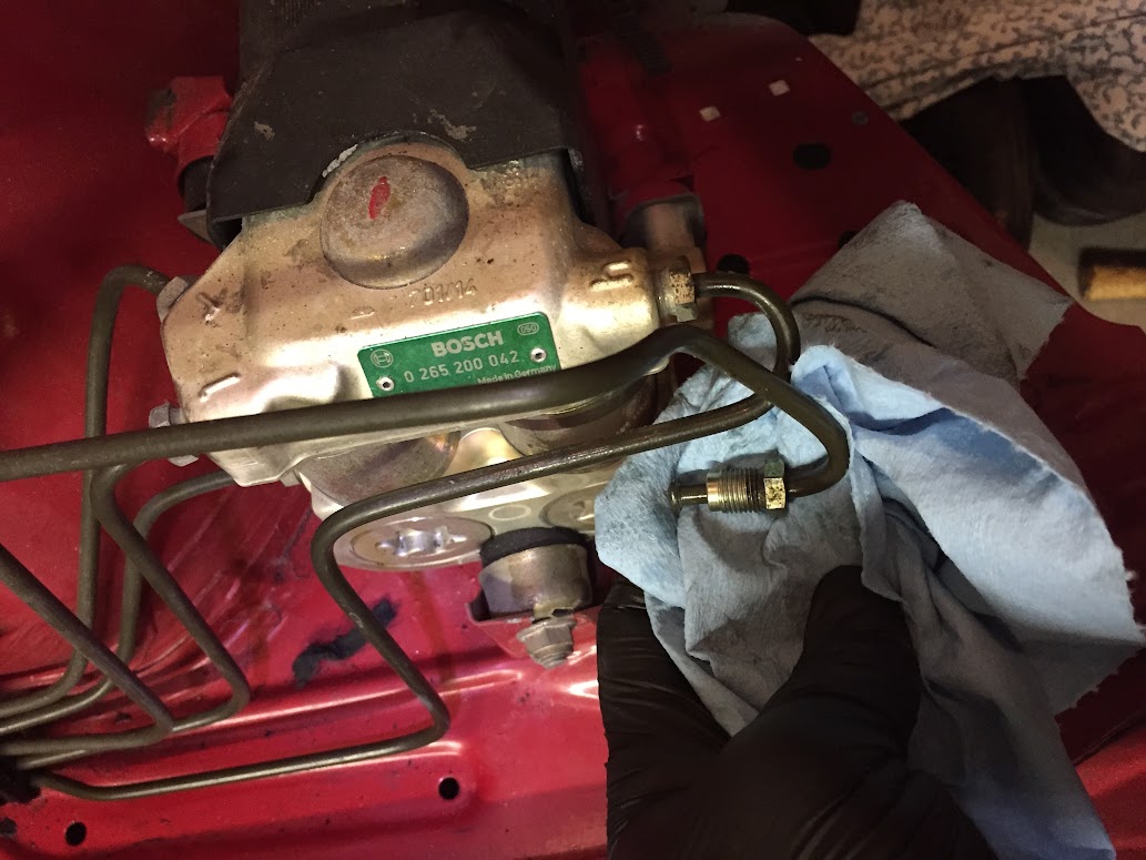

Now, ABS unit. I did way more labeling here than is necessary, but painters tape never killed anyone...that I know of.
The lines run through the round rubber grommets you see on the right of this pic, and the cylinder in the middle is the brake pressure regulator.
More tagging
Disconnecting from the chassis
fast forward, and...

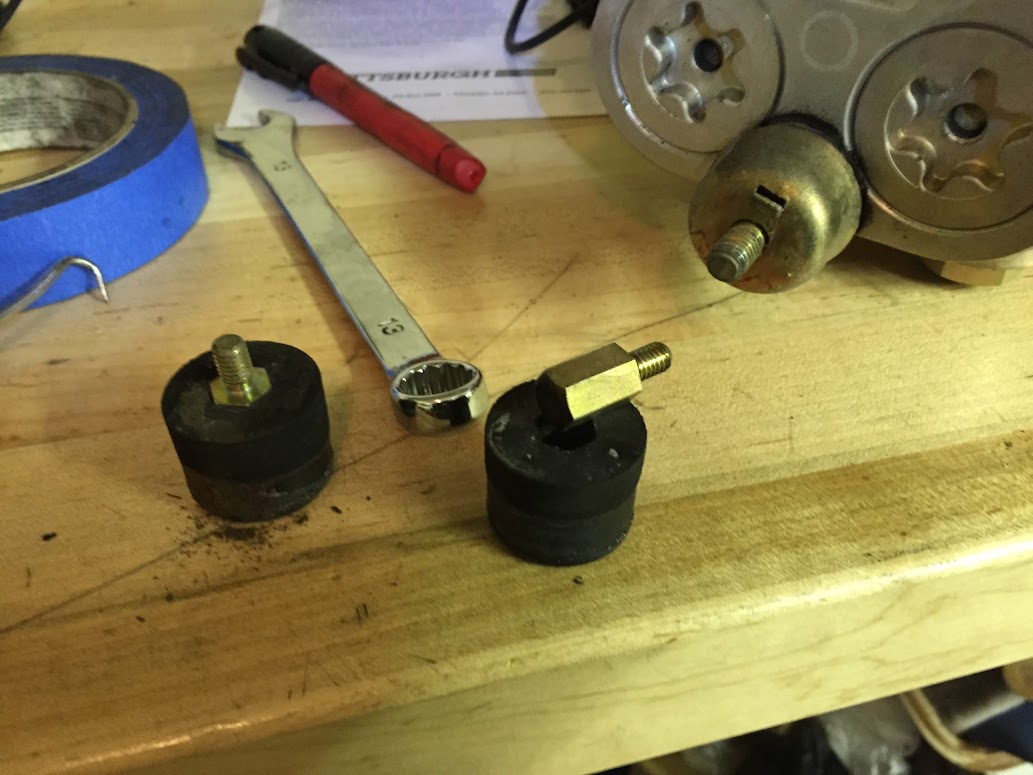

The anti-vibration feet are two piece metal and rubber
Then I manually drained the fluid and caught the excess in a rag. Air compressor helped here
And unattached the brake lines from the junction point with the rubber brake lines in the wheel wells
Solid lines out. These were in really good shape. With some cleaning up/polishing i think Ill reuse these.
