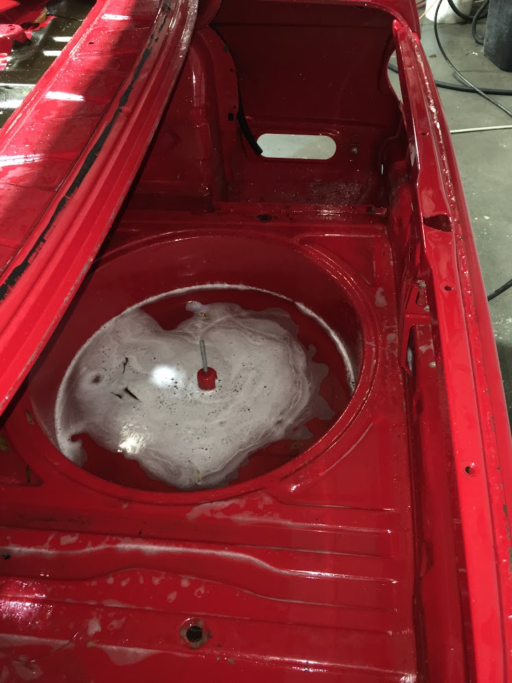

                      #295
                      Body Work
                      Alright, I've held out on you long enough with body work ;D
                      PRESSURE WASHING
                      INITIAL SANDING
                      The guy in this picture is Steve. He's the tech doing the work on the car - and he is VERY good. You cant see it very well in these pics, but there's a 60's mustang he is converting from a coupe to a fastback.
                      Remember how the passenger side was all dinged up and looked like a golfball in some places? Yeh, not anymore.
                      I'm going to replace the hood because it will give a better result than smoothing out the existing one, but the rest of the panels are ALL being restored like this.

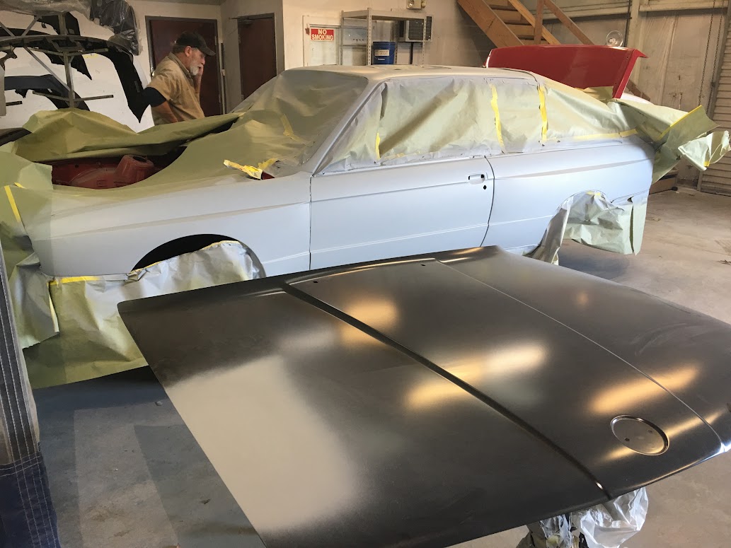

                        #296
                        Two years.
                        Happy second anniversary r3v. I've moved twice since buying this car, but the project goes on. Visited the car in the shop yesterday and snapped a few more pics. Nearly done with the first coat of primer - then block sand again - then second coat of primer - then paint!
                        You can see the new hood here as well.

                              #299
                              given the amount of work you're putting in to this, why end up with a non-numbers-matching hood?
                              speaking of the amount of work you're putting into this, awesome awesome job. this is a fantastic thread.
                              cars beep boop
                              • CurrusDei
                                • Mar 2014
                                • 673
                                #300
                                Two Years In... M3 Build Thread...Now in Paint!
                                Thanks!
                                To correctly paint the car, all the vin tags have to come off. Otherwise the paint will peel up around where the old tags were even if you carefully mask them off.
                                Fortunately, there is a company (one company) that is authorized to make replacement VIN tags for BMW in the US. I have taken pains to document the originality of each panel by taking photographs of the original VIN tags in place-so that I can establish it is a true numbers matching, accident free car even though the vin tags are new, licensed reproductions. I'll even have the original hood if I ever want to sell someday.
                                Also, the hoods are really hard to refinish. Any dents or other damage that needs to be repaired is really hard to sand on because the metal is thin. Know how if you've ever seen someone sit on a hood and it makes that sickening metallic popping sound? That's what happens with the sander - very very hard to avoid having defects in the final paintwork. Since the hood is the biggest flat surface on the car, replacement is the best option. Even though the old hood was in pretty good shape for its age - that's a long way from perfect.
