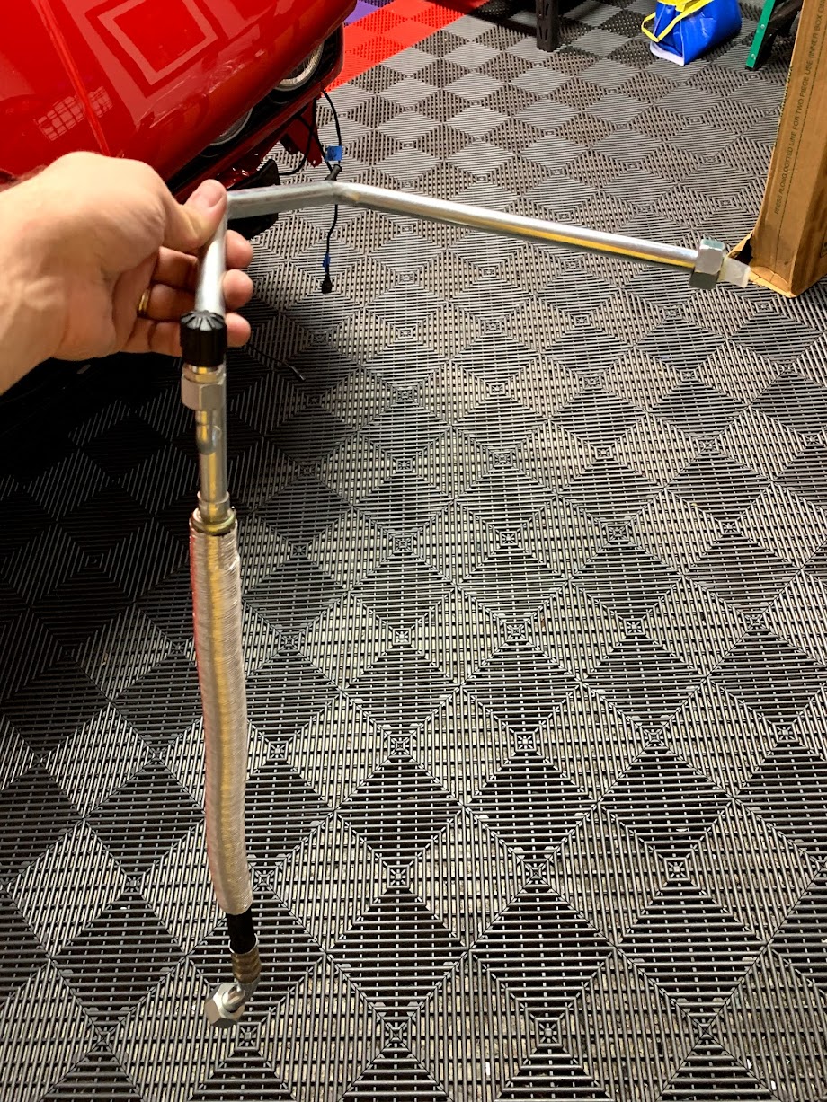

          AC Lines Going in. As of this writing the AC still isnt done because im finding that the new style bracket, while it fits on the engine, doesnt position the larger fitting on the compressor (which receives the larger, low side line from the expansion valve) high enough for the line to clear the frame rail so that it wont rub on the body. Also the new style bracket only mounts the top of the compressor with a single bracket, which is not strong enough to keep the compressor pulley square with the drive pulley when tensioned. As a result, the compressor pulley angles slightly and freys the edges of the drive belt.
          TLDR: I'm going back to the old style bracket and having my factory compressor rebuilt.
          Anyway, the lines:
          This set runs under the passenger side of the dash and is the only set of lines that werent replaced with new (theyre NLA). I foundthe nicest used set i could and had them professionally cleaned out by an AC shop
          and re-insulated the low side line
          All new o-rings from BMW
          I used PAG 100 oil to soak the o-rings and used mineral oil from an AC shop to lube the threads so they dont seize up. everything went together smoothly, but some of the lines are in tight spaces so wrench clearance is minimal. Just takes patience
          New expansion valve I've had waiting for years
          This is a tight fit
          Oh yeah and dont forget to put the cover on the lines before you install them, so you dont have to undo the whole thing and slide the cover over. This wasnt my favorite part of the project
          New R134a low side line
          in place. sits higher than the old low side line, which follows the lower edge of the shock tower
          new high side line (connects drier to expansion valve). Its the gold line running just under the hood seal.

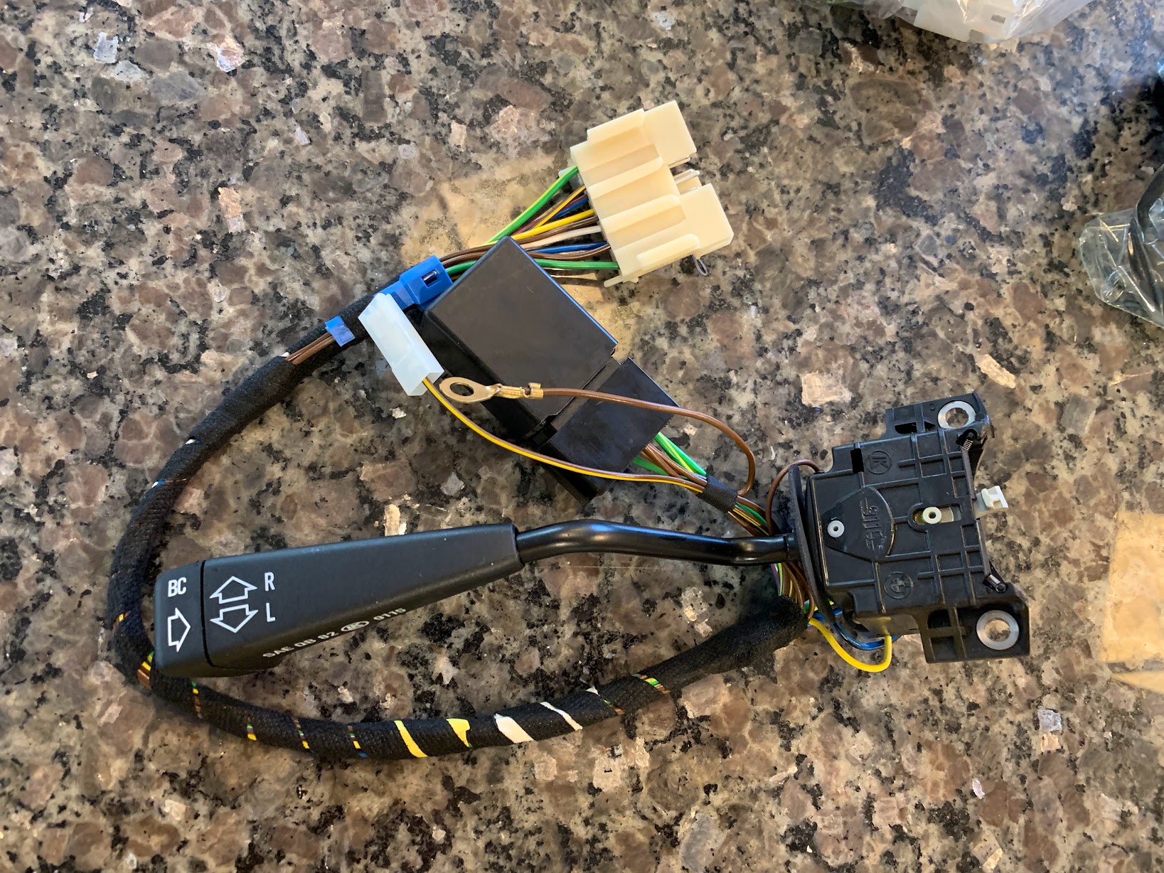

              Stalks being re-wired
              My old turn signal stalk was faded and worn out. The non-airbag turn signal stalks are twice as expensive as the airbag car turn signal stalks. Since my car was made late enough to have airbag provision wiring but no airbag, i tried the airbag car switch. Works perfectly. Wouldnt be surprised if it worked for older build dates as well but try at your own risk. I had to re-wrap the wires on it, even new from BMW the wires were sticky so it go the same treatment as the rest of the wiring - cleaned and re-tesa taped.
              Top half of steering column cover on
              Bottom half
