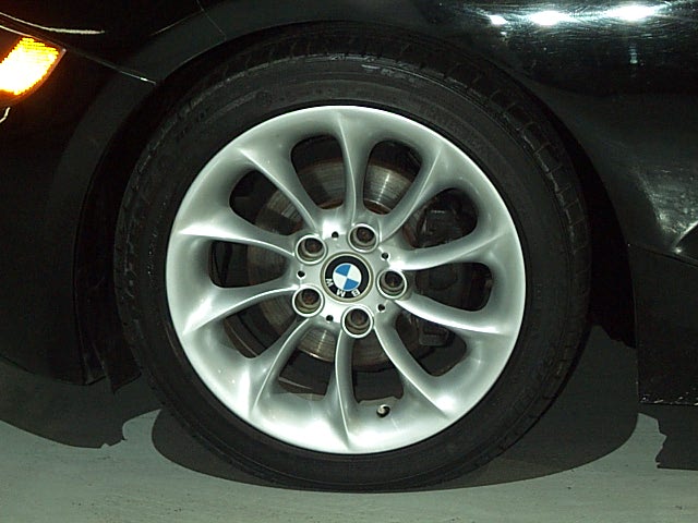

    Z4 wheels
    17x8 5x120 et 47.
    Survey says?
    Anyone seen these on an e30?
  • Wishno87
    • 6025
    Naw. look too modern. There are some good Z4 wheels that would look good on a E30 though.

      groooooosss

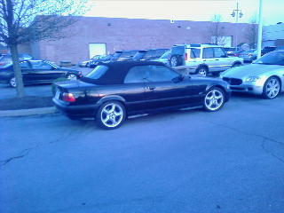

                        • bimmer630
                          • 1228
                          This E36 came into the dealership the other day, with 5 spoke E53 rims on it.
                          • daniel
                            • 6703
                            holy white balance being off, batman
                            http://instagram.com/dslovn.drives
                            • bimmer630
                              • 1228
                              cellphone cam
