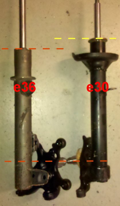

    Just to reinforce it:
    YOU MAY HAVE MADE A MISTAKE
    e30 insert is 17" long, while e36 incased insert is only 16". If you consider the way both mount, e36 strut still sits lower than the e30 one for a little extra shock travel.
    I just went and took a picture of an e30 strut next to an e36 strut, and posted it in the gallery thats in my sig.

      yes, you took a pic of the e36 housing... now take it apart. Take both inserts out and snap a pic.

          But where the bumpstop is, which could vary even inside the shock, is what really matters travel wise. Not to mention a really long housing, even if in theory the bumpstop was way down, would still cause travel issues because of the housings physical hieght..
            I think my latest picture, and others in my gallery are helpful. Almost half of them have nothing to do with our company. (The washer that everybody leaves out but they don't know what to look for, how to tell when your Bilsteins are bottomed out, etc.)
            yes, you took a pic of the e36 housing...now take it apart.
            Um...all e36 housings are sealed, and cannot be taken apart except by cutting them, (and then you cant measure them anymore).
            e36 does not have an insert that can be photographed.
            Also, and I'm sorry if you're not shamelessly plugging your product,
            If I was, I would have put a picture of the GC parts next to the stock parts.
            But instead, I went and assembled a stock e30 strut (see the brand new oem gland nut in the pic?) and a stock e36 M3 strut, and took a picture of them next to each other.
                  I cut off the top ring of the e36 strut housing. The squeezed part holds a spacer and a seal to hold the pressurized assembly in. Then I pull out the shock/strut-like insert out. That measures to be one inch shorter, than e30 insert.
                  I make a spacer for a short Bilstein and weld on the threaded part. This way I run e30 Springs on e36 spring perch, drops front end about 15mm.
