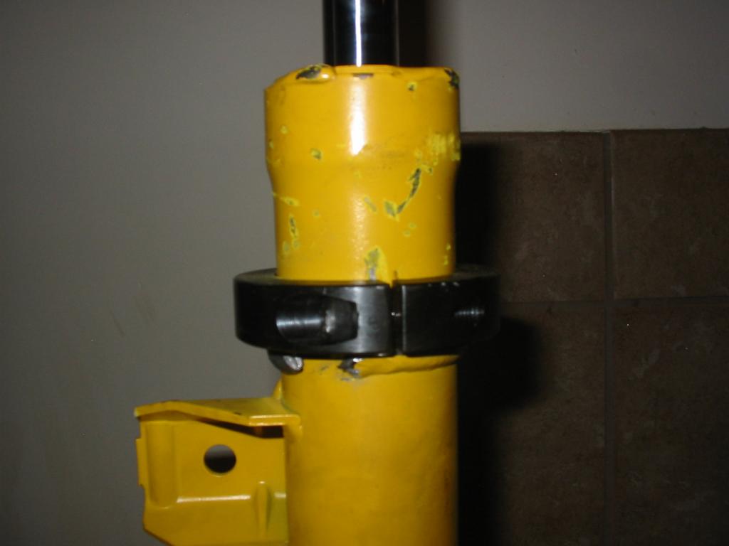

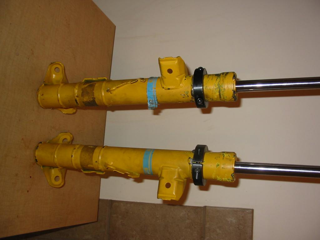

                What kinda struts have you guys used when installing ground control or other brand coil over kits? I just got a deal on a set of New billy sports for an early E36 (with the swaybar tabs) and was expecting to be able to mount up these coil overs I had gotten off of some stock struts. well the billy strut has a larger diameter tube at the top that tapers down. I dont see how the threaded sleeve can be installed on this strut.
                • bimmer630
                  • 1228
                  Heres what i came up with to solve my whacky strut tube dillema. These split collars were pretty cheap and they will provide the "shelf" needed to rest the threaded GC coilover sleeve on. the welds left over from the original perches will hold the sleeves up.
                  plenty of loctite on the threads and maybe even a few welds to hold the two halves together will keep everything safe

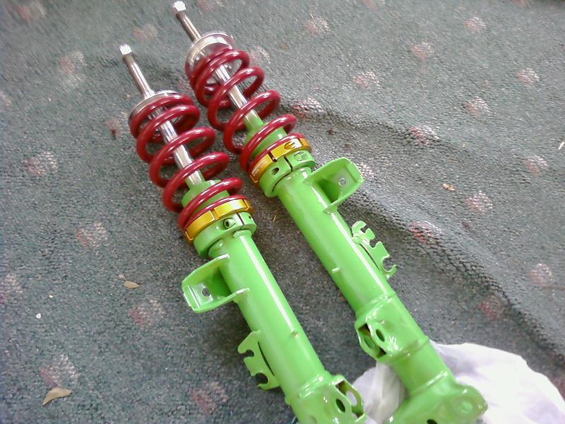

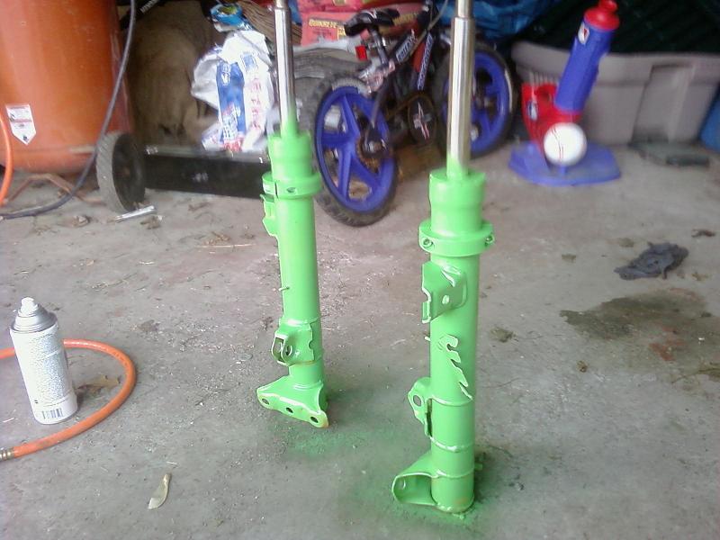

                    The Ground control parts arived today. They boxed the wrong sleeves but I got on the phone with them and they're shipping the correct ones out asap.
                    I put the adjusters on the struts without the threaded sleeves to show whats gonna happen. I thought bright green would look cool too
