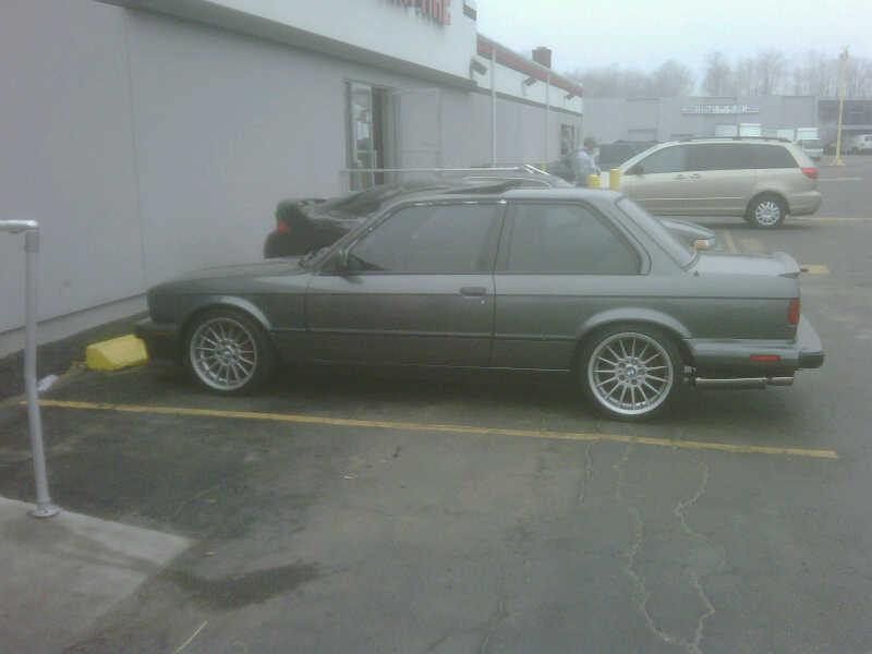

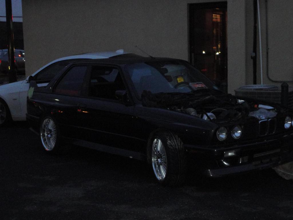

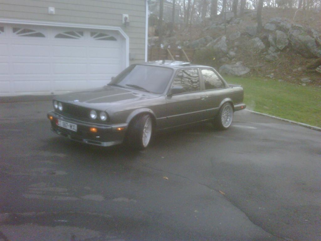

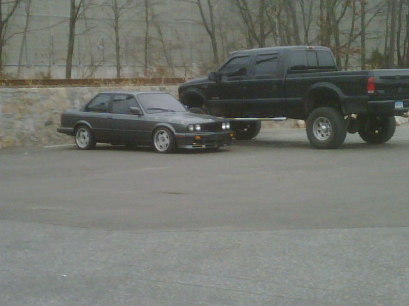

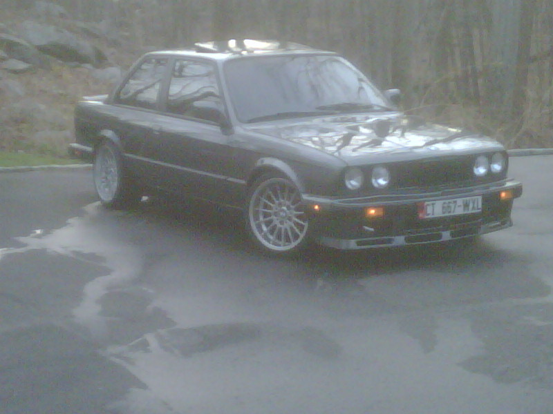

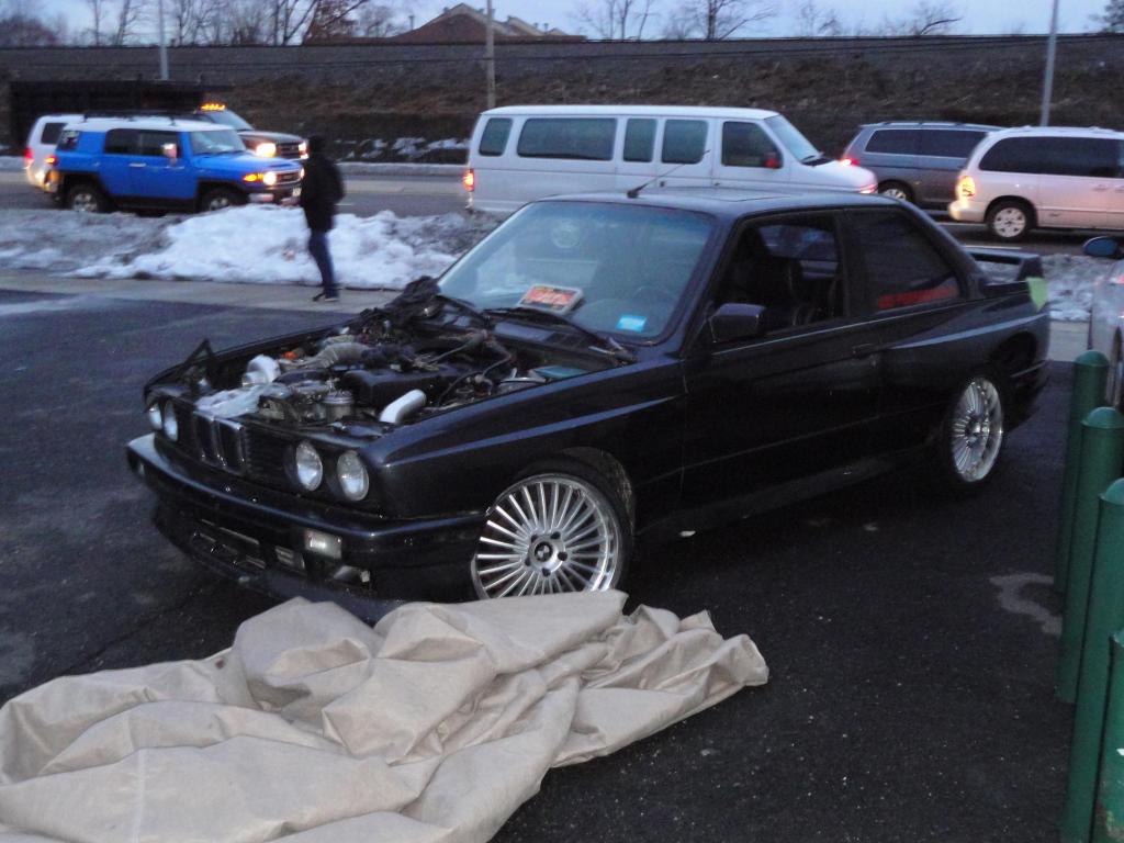

                Too bad he just sold it that was a nice set up I sold him springs and shocks and sways just so you have an idea what they look like with tec3 with one coil cut in front and no hats on neither front or rear and billy sports...
                Here some pics with style 32's staggered and Borbets type A 16x7.5 Click image for larger version

                      I'm not in a huge rush to get this done. I'm just bummed because my car is quite unpleasant to drive w/ the screwed up strut housing. Zennone, your car looks tits!

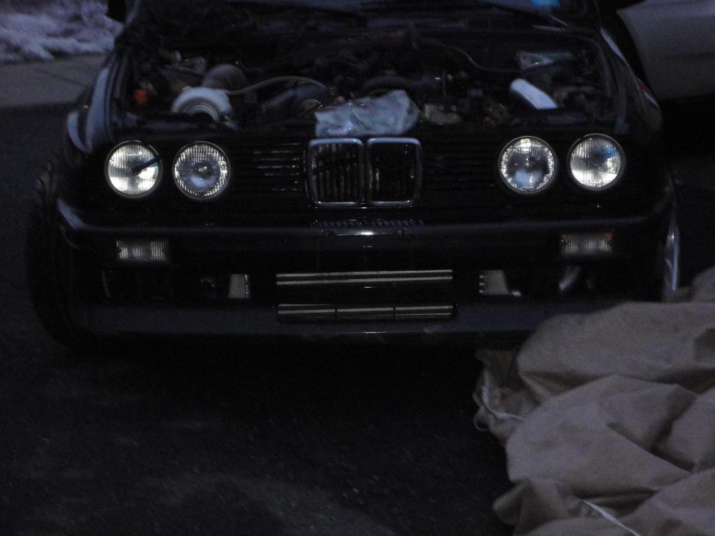

ID:	7127645 Thanx but wait until this 800+whp monster is done sorry for thread jacking just got excited
