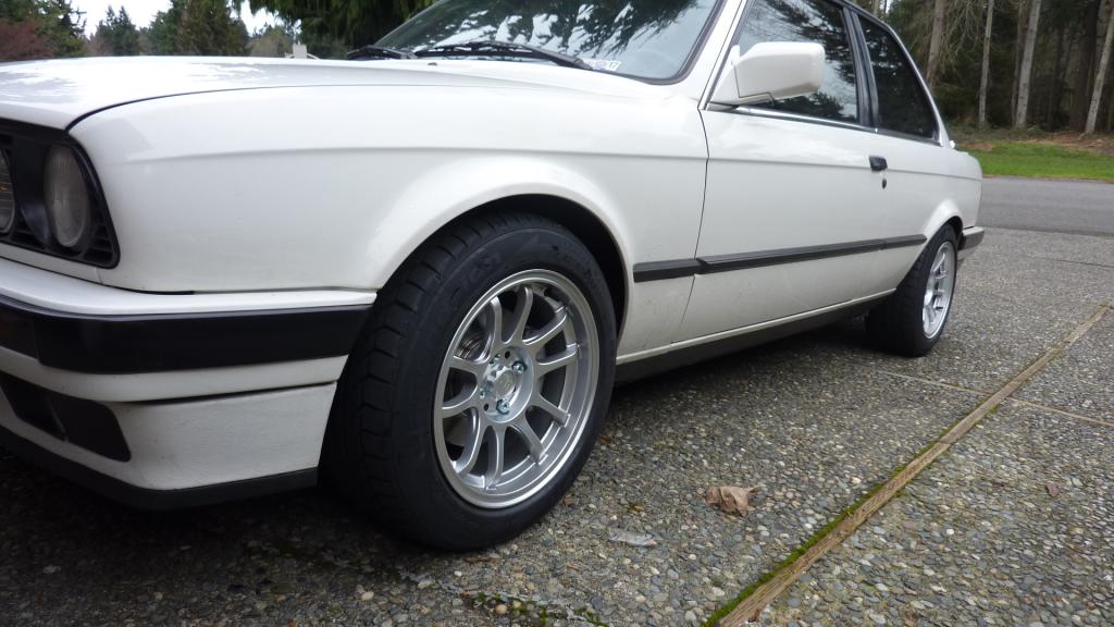

    Call me a heretic, crazy or just sentimental; but I swapped my 5 lugs back to 4.
    No, I'm not swapping back to the m20, too...
    Here's the figures I recorded from the un-swap:
    Front. fully-dressed e36 M3 struts w/control arms, springs and everything ready to bolt in weighed 72 lbs.
    The e30 struts with all the same stuff weighed 56 lbs. 16lb difference.
    My TRM C1 15x8 with 215/50 tires weigh 35.5 lbs each. The front DS2 weighed 40.5 each.
    That's 21 lbs per corner or 42 lbs off the front.
    In the rear, the 318ti hubs/rotors/calipers only weighed about 4.5lbs more, but the 245/40 wheels weighed 46.5 lbs each. So, 4.5lbs in suspension and 11lbs off the wheels. 15.5 lbs per corner or 31 lbs off the rear.
    The total here is 73 lbs of sprung, rotating mass.
    The car feels quicker and noticeably livelier. The downside is that the m3 brakes were just plain awesome but other than that this is a much better daily driver.
    Yes, I could have found lighter 17" wheels but it would have only made a small difference in the front.
