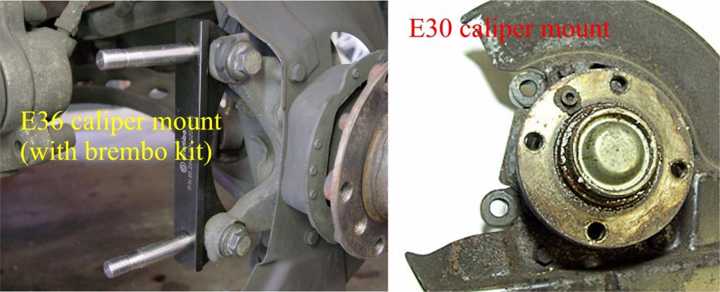

                    1. Someone mentioned E46 arms. They claimed that E36 guys are swapping them in for more camber, but I cant find any evidence of that. Plus, they have a hex shaped end where it goes into the CAB.
                    2. This seems like an obvious question, but has anyone ever tried:
                    - Install a E36 or E28 wheel bearing on a E30 strut
                    - Use an E28 or E30M3 rotor
                    - Figure out what happens with the caliper to make it work
                    There was a guy on Roadfly that claimed to have put E28 stuff on his car, but he said the caliper bracket was the hard part. Maybe the E36 caliper bracket would work? All I'm saying it that it sure would be nice to keep E30 front end suspension parts and have it more like a E30M3 setup.

                      If you look in the track forum on BimmerForums there is quite a bit on the E46 CA's, RRT also sell modded ones (hex issue resolved).
                      Covered plently, No other BMW hubs fit onto a E30 spindal, end of story.
                      I have heard of E28 struts being used on E30's but haven't seen any pics.
                      I imagine the geometry would be pretty wacked (comments in another thread on here).
                      Yes the eccentric bolts reduce the tyre-strut clearance.
