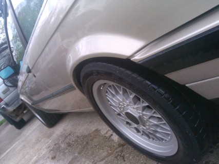

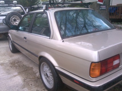

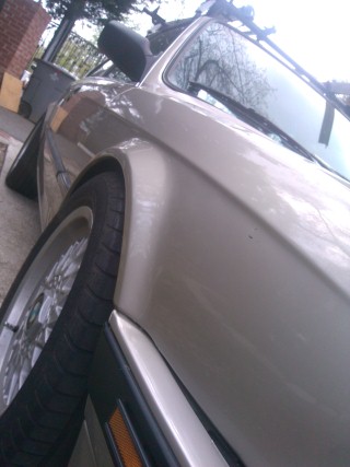

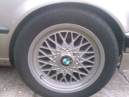

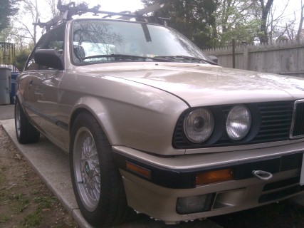

                here's mine with 96+ front and Ti rear sitting on e36 race springs, but will be changing it out for e30 sport springs soon.
                did everything including new rotors/pads/ball joints and bushing, everything else is nused/reconditions. under $500, just have to look around and collect pieces and if you have a yard or look on e36 forums for part out. gl
                drives beautiful, i recommended going with the m3 swaybar mount instead of the regular, make it feel you have a stiffer bar.
                running Ronals 16x7.5 square with 205/40/16
                I just wanted to add, there are many quality kits from engineers/members on here and if i have the money i would of gone the bracket setup for the front and e30 m3 bearing/hub rear. But i happy with this budget setup.

                  Originally posted by e30mpg
                  here's mine with 96+ front and Ti rear sitting on e36 race springs, of gone the bracket setup for the front and e30 m3 bearing/hub rear. But i happy with this budget setup.
                  Are you saying you used 1996 328i front suspension parts? IF so what did you do to get the caster right?
                  • e30mpg
                    • Dec 2012
                    • 187
                    96+ m3 arms
                    m3 offset bushing
                    m3 struts
                    m3 springs
                    e30 strut mounts
                    you should be golden
