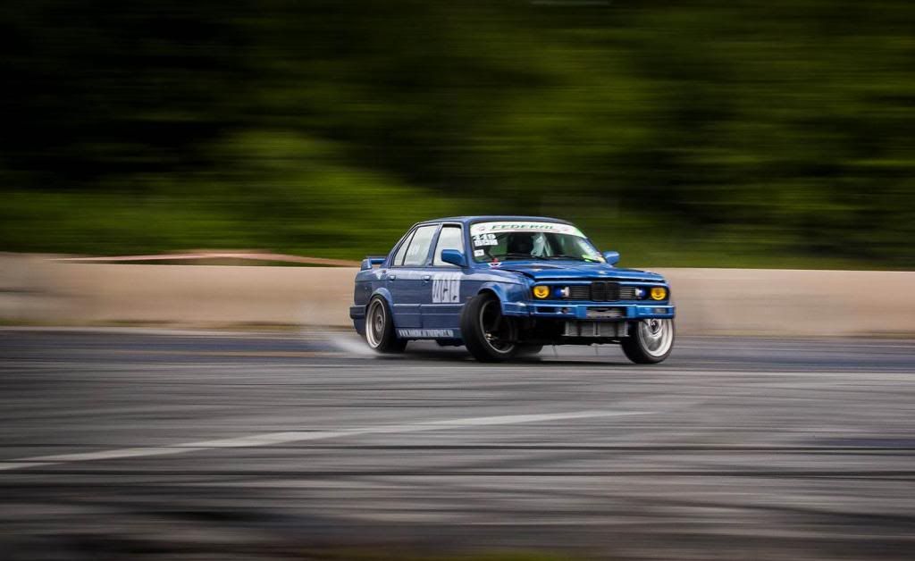

  • Max399
    replied
    Originally posted by Bglad
    What kind of warranty and testing have these gone through? Would they be Ok for an occasional autocross or lapping day?
    You're welcome to autocross with them, here in Lithuania these are even used in drifting. Company that makes them is producing all sorts of sports hardware. Such as engine mounts, strut bars, spacers, hydraulic handbrakes, short shifters, polyurethane mounts and all sorts of different hardware.
    And essentially - there's nothing that can go wrong, its just an adapter that fits on the spindle and acts as a spacer to allow you to use a different hub. You tighten it the same way as you would a normal hub, only difference is that there is an extra counter bolt to make sure it doesn't untighten itself.
    And the caliper adapter is tightened the same way as the stock one would.
    Here's one of the drift cars using their lock kit:
    And here's some other parts the company makes:
    Leave a comment:
