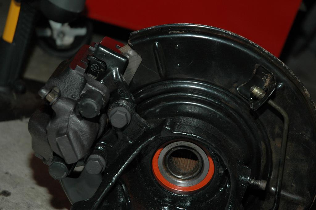

      I was happy to put my e36 caliper back together with their 36mm pistons and the 318ti carrier.

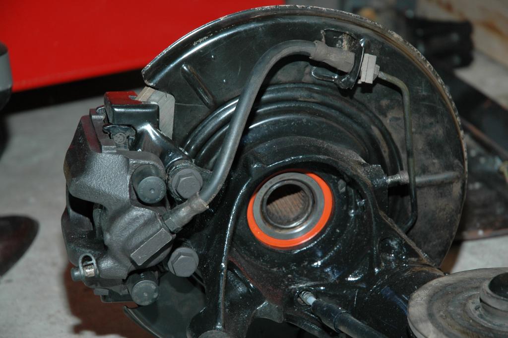

      I was very proud of myself until I got them on the trailing arm and realized that the brake hose mounting is different on the e36 calipers! They are oriented 90degrees off. I have a choice of either getting the proper hose orientation or getting the bleed nipple on the top.
      You can see the where the hose attached at the end of the rectangular section. On the 318ti it points towards the hard line.
      What to do?? Any 90 degree fittings available? Alternately, do they bleed with the bleed nipples down??

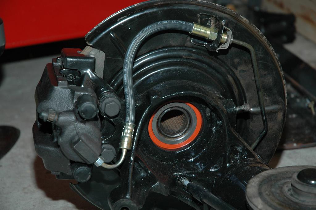

              So the current state of the art is that in order to use the e36 non-318ti calipers I need to mount them on the opposite side in order to use the stock hose. The bleed nipple is on the bottom and I need to stand on my head whenever I want to bleed the brakes....
              Option two. Go to local hydraulic shop and fabricate a couple of hoses for $40 that let me mount the calipers in the proper position so that bleeding doesn't become a hassle. The brake line *may* need to be removed to remove the caliper, but that's it.
              Parts used:
              (2) BQ4511 Tube Nut 10x1mm x 3/16
              (2) HF02 Fitting-universal ext 3/16 bundy tube
              (2) HFMF05 Fitting- Female 10x1mm European (DPS)
              12" 1/8" brake hose
              $40, assembled and pressure tested to 3000psi

                So the problem is stock brake lines aren't long enough to reach the bottom input when you swap from side to side? Those lines look slick, and good to know that regular e36 calipers have slightly bigger pistons, should help with brake balance a little for those who use e36 m3 front brakes. I don't track my car so I haven't had any complaints with my m3/ti setup but I'm sure others might, front locks up way before back in my experience.

                  The problem is not only that the stock lines aren't long enough, but if they were longer they wouldn't be able to make the 110 degree turn without kinking.

                      Looks proper and great steve. Thats the best way of fitting those calipers, no monkey business like i described :P
