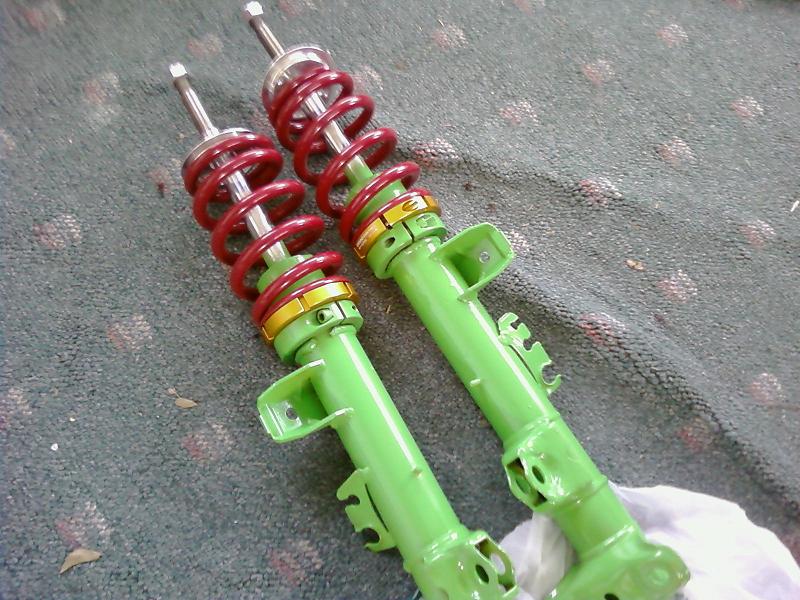

        Yo man, you stole my strut color idea lol
