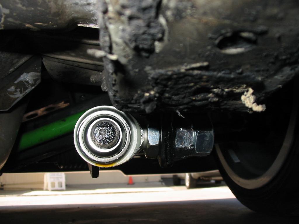

      My man Todd at Dynotech Motorsports (www.dynotechonline.com) hooked me up with these and it more the fixed the caster and increased handling like a razer. I was running delren before I went 5 lug and it's night and day between the two.

        that's interesting, what is it mounted too? or did you weld on extra bracket?
        I always wanted a cross bar to tie both lollipops together and make them adjustable... It would stiffen chassis and allow another adjustment.
            Todd custom fabricated a bracket using the original bolt hole locations.

                Its going to a smaller than that, but yeah. Same idea.
                I need to get my ride height set at the proper height and I will decide how much caster I need to get back to stock specs.
                I am trying to get auto-cad re-installed soon so I can draft this thing up.
