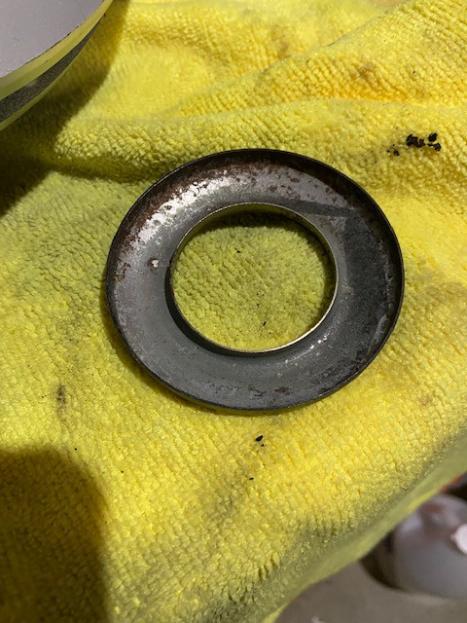

            I know this thread is over a year old, but I ran into a similar issue with this kit too. The fix was to remove the sheet metal dust seal that’s pressed onto the base of the spindle. The rear sleeve cannot seat without that being removed. Once that is removed, everything seated perfect and the caliper brackets are centered. The instructions never mentioned it.
